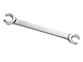

Invest in a simple set of metric flare nut wrenches. It will take the worry out of loosening those banjo bolts.
