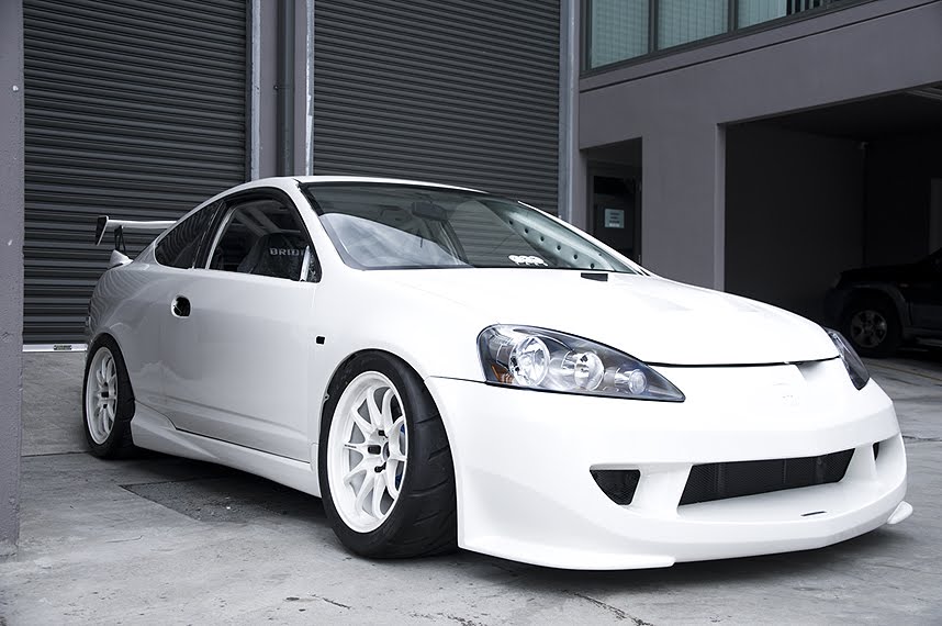

2 inch drop and a 225 tire would be perfect.... if you really want a nice stance camber the rear about 1.5-2 degrees then run a 10mm spacer in the front and camber about 3-3.5 degrees so it looks like this:
it gives the car a more aggressive turn in to compensate for the added tread.
another thing to be sure to match the stiffness of the suspension to the tire... if you mess that up and run a cheap tire with a stiff shock you will understeer and plow and bounce like a toy.
stiff shock/spring = stiff tire
soft shock/spring = soft tire
otherwise... well youll see what i mean.
