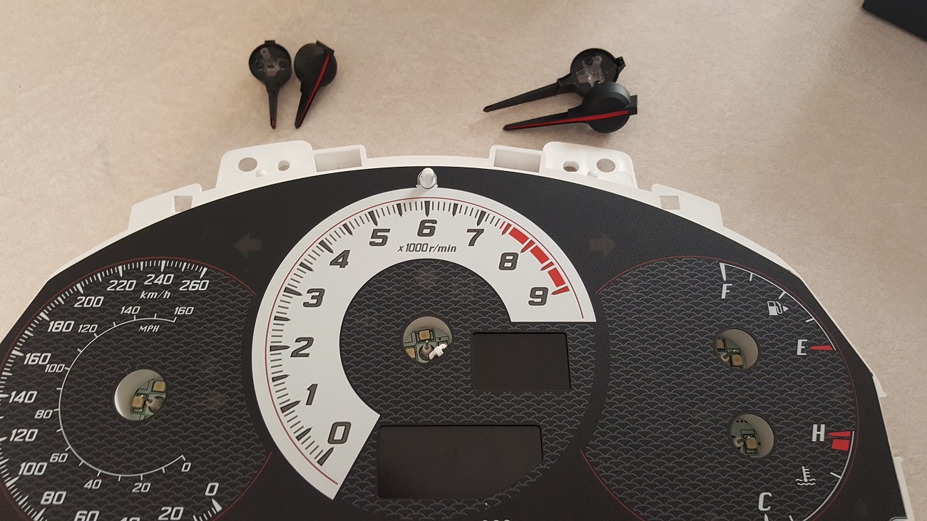

Step 3) Remove all the needles. Note the position of each one very carefully as you have to be very meticulous putting them back EXACTLY where they were. Be very careful here, you have to lift straight up. You will end up with this.
Attachment 114645
Step 4) Lift the faceplate off and lay down the new one.

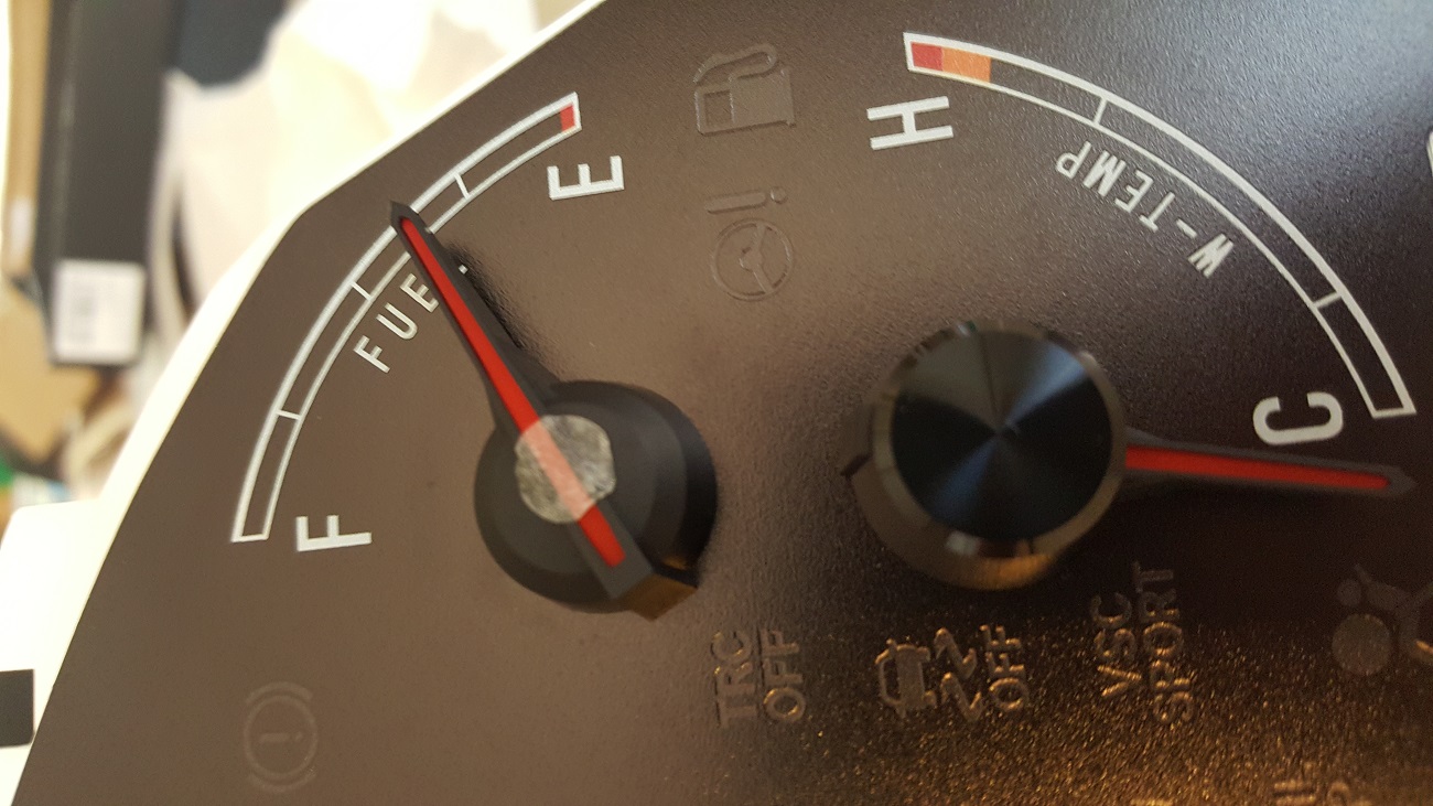

Step 5) Push the needles back on, Be very careful to not push them on fully at first. Once it is on a little turn them until you hit the stopper and use that as a reference point to reset them. I.e. spin the temperature needle to the left until it hits the stopper, that is where it will be when the car is off so the needle should point backwards slightly. You can just use a small amount of force to get the needle to rotate while the motor is held to the stopper to help you line it up. You will get this. I also chose to get needle caps too so this is me applying those.

weird calibration
Was switching them out, put each needle back in carefully and to the correct positions so that when my car is running everything is accurate. But whenever I turn my car off for a few hours and come back, the needles drop back down to where my gas is at empty (when it should be at half) and my rpms dropping 1000k. Any thoughts on how I should get these to stay calibrated?

Well I messed up and now my fuel gauge needle isn't pointing to where it's supposed to be. Unlike the other needles, which have a "stop", this one just spins freely so should I maybe fill the tank and then manually set the position to "full"?
