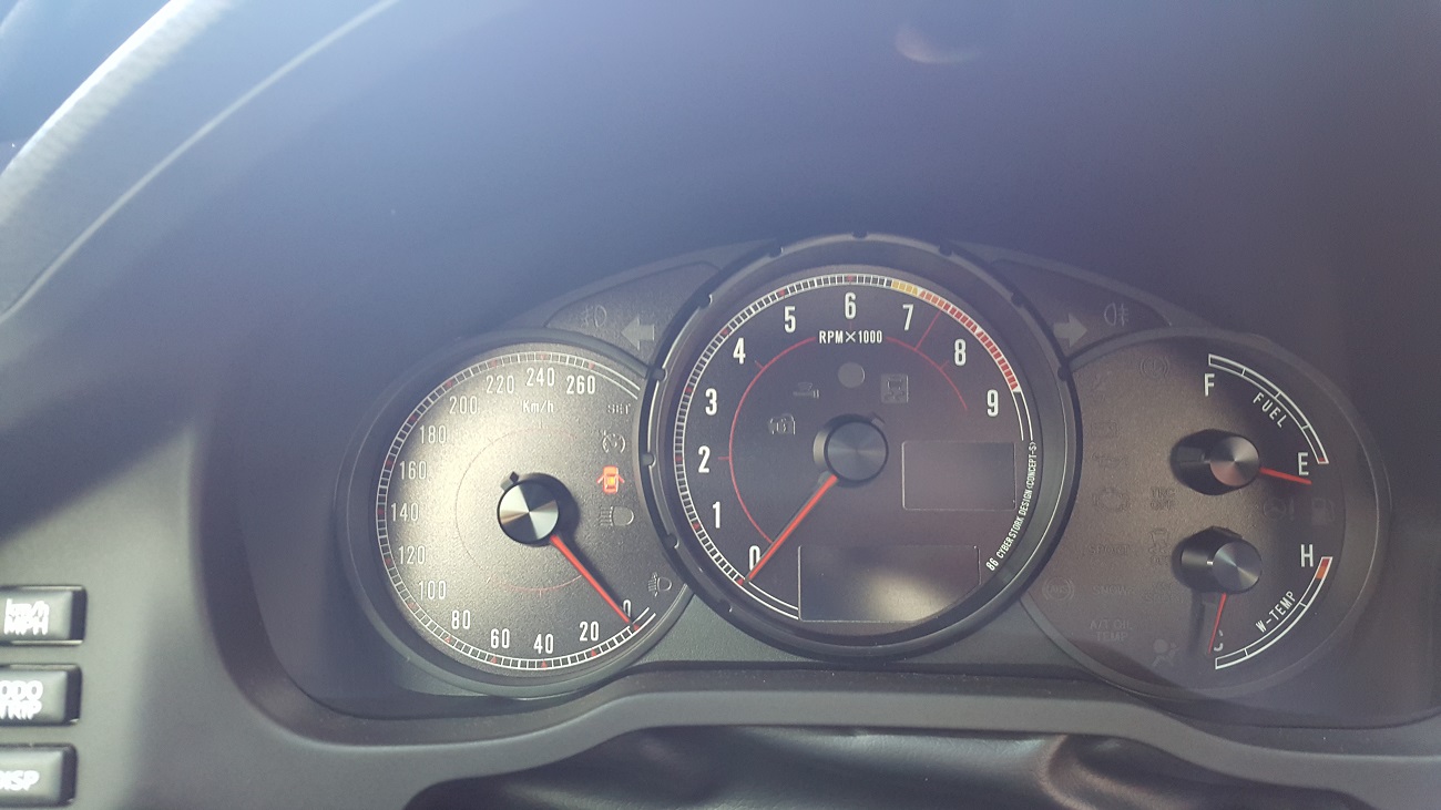

Hello everyone!! This is my first DIY so here it goes. DO AT YOUR OWN RISK. This is the goal
Edit: I ordered my parts from @Max @ 86WORX
I cant figure out how to post a link from my phone :( but its easy enough to find on his site. They are under interior parts.
Attachment 114643
Step 1) Remove the gauge cluster from the car. There is another DIY on here on how to do that, It is really easy and if you can't do that you should not be attempting this.
Step 2) remove all the plastic bits, I chose to paint my silver ring black so I removed that too for painting.
Attachment 114644
Step 3) Remove all the needles. Note the position of each one very carefully as you have to be very meticulous putting them back EXACTLY where they were. Be very careful here, you have to lift straight up. You will end up with this.
Attachment 114645
Step 4) Lift the faceplate off and lay down the new one.
Attachment 114646
Step 5) Push the needles back on, Be very careful to not push them on fully at first. Once it is on a little turn them until you hit the stopper and use that as a reference point to reset them. I.e. spin the temperature needle to the left until it hits the stopper, that is where it will be when the car is off so the needle should point backwards slightly. You can just use a small amount of force to get the needle to rotate while the motor is held to the stopper to help you line it up. You will get this. I also chose to get needle caps too so this is me applying those.
Attachment 114648
Step 6) Optional: Paint the Silver ring (note the japanese news paper that came as packaging for my overlay/needle caps #JDM lol!)
Attachment 114649
Step 7) Reassemble!! Note I mixed up the tach and speedo meters so this pic is not right!!
Attachment 114643
Now Just go test it!! :party0030: Here is 1 lights on shoot in the day and a poorly shot picture of lights off during the day.
Attachment 114650
Attachment 114651
I am pressed for time so that is all for now! I may or maynot update this depending on the demand. P.S sorry if I cant spell

I am really happy with this product so far but the only thing I have noticed is that the MIL lamps are not nearly as bright as they were when it was OEM. It is not a big deal as you can still see them easily but they are less likely to catch you eye when your driving. The up side to this is that if you drive around with your trac off all the time the light wont bother you much anymore.
