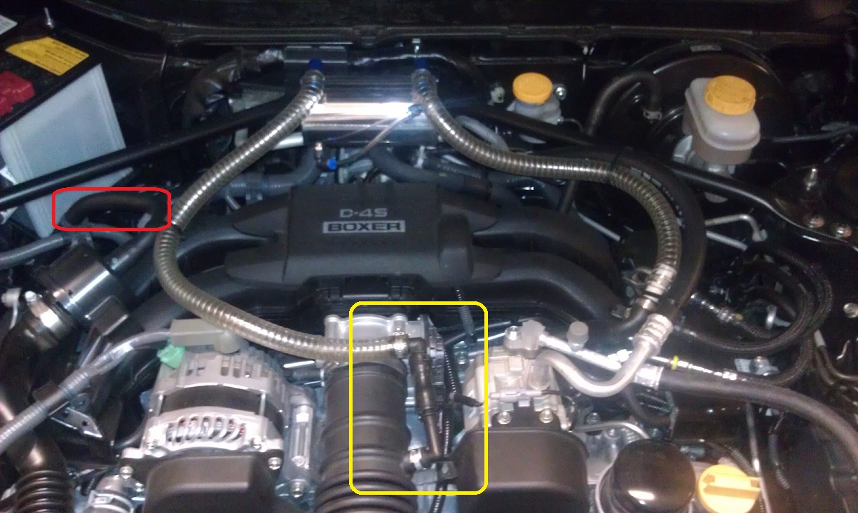

Initially, the tube from the catch can was zip-tied to the tube circled in red, only further down and out of sight, and dumping the fumes straight down. This was a very clean look, but I had to recirculate to stay legal in stock class for autox.
As I didn't have time to meander around home depot to figure out how to recirculate and make it look nice, I took it to a local shop and their quick jerry-rigging work is highlighted in yellow. I plan on redoing it, but it works for now.
Hope this helps!

Originally Posted by PekoPeko View Post
Attachment 10139
Initially, the tube from the catch can was attached to the tube circled in red, only further down and out of sight.
Doesn't that tube feed into the passenger footwell?
Yessir, that's the back end of the sound box.
ya, sorry... lack of sleep, not good thinking...
I meant that I had it tied to that tube going down so that it didn't flail about. The tube itself (the one from the catch can) was just dumping downward. Looked a lot better than how it looks now, but not exactly the most environmentally (or track) friendly way to do it though. Same as how it looks on Moto's car.
http://www.ft86club.com/forums/showt...ighlight=cusco
6th picture in first post.
