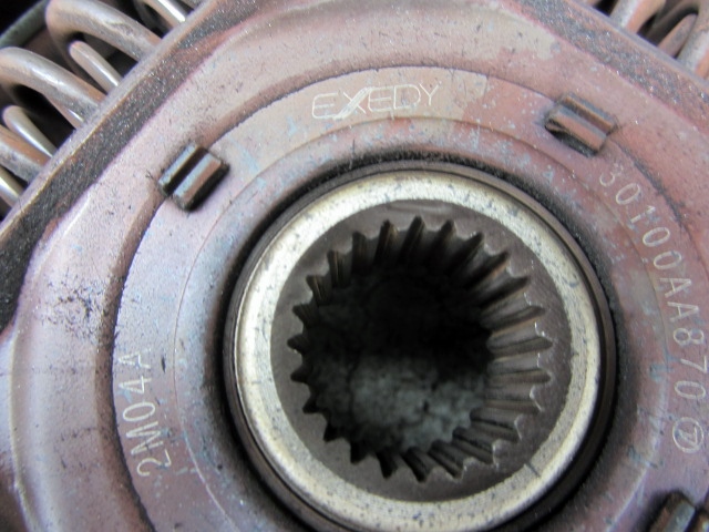

Oh
By the way, this is the OEM clutch.
It's an Exedy
WNDSRFR is offline   Reply With Quote
