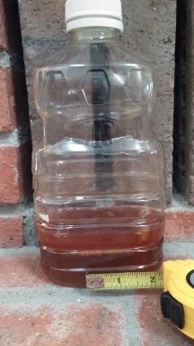

This is amount of oil I collected in the oil catch can in about ~5K miles from PCV side only. You decide if you need a catch can.
