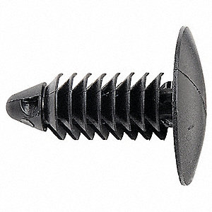

I first plugged the holes with plastic plugs like this then wrapped my trunk. Worked OK.
This could also be an option but I'm not sure if the new wing will sit flush or sit properly with these installed.

I have used some plastic plugs that I got from Lowe's that worked fine.
{Picture of plug}
If you wind up going this route I would recommend putting a small dab of silicone under the head of the plug so you're sure no water will be getting in under it.
