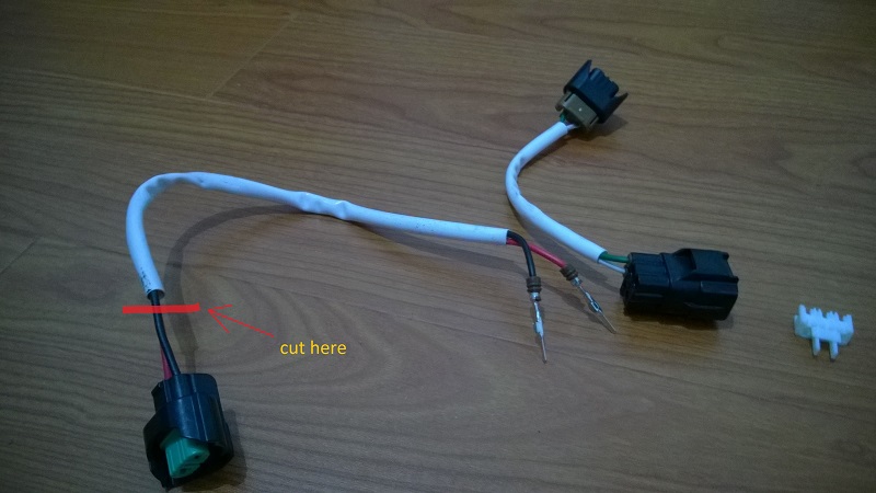

Originally Posted by RWfan View Post
this DIY is for this product.
here's the link:
http://www.ebay.com/itm/SCION-FR-S-W...-/191335866653
Attachment 107984
i thought i was getting the FT86 product for a third of the price but after watching their video, that's when i realized that i did not...
...ill spare you the details on how i got it working and just show the results.
OK, this product came with an installation guide. STEP 1, STEP 2 and STEP 3. i need you to put a pause on this for now. we will incorporate both guides(eBay & FT86) to complete this install.
Attachment 107989
the main difference between these two products is that the FT86 model came with an extra pin and the eBay item did not. you are going to need those missing pins so lets start.
what you need to do is to pay close attention of this segment(0:09 - 0:23) of the video from FT86. this will show you how to take the pin out of the harness.
you need to get your stock(OEM) headlights and look for the harness that is similar to the Winjet harness as shown on the video. you are going to unpin two of these wires. the picture below is the harness that came from the stock headlights.
Attachment 107985
make the cut at least giving you four inches of slack from the pin to give you extra room to work with. this was painful for me to do but essential unless you can get a hold of these pins somewhere else.
Attachment 107986
you will notice that there's a brown rubber grommet on the pin that came from your stock headlights. do not worry about this for it will just slide back out when your about to install it. you'll know what i'm talking about after watching the video again.
Attachment 107987
you are now going to splice one of the wires where you made the cut on the end of the white wire to the eBay harness using the red wire tap provided as illustrated below or you can do the cleaner look...ie.solder & heat shrink.
Attachment 107988
repeat process on the other harness...
time for the install.
looking back on the FT86 video, do exactly what the video is showing from start up to 0:57. the provided pin is the pin we took from the stock headlight.
looking back at the installation guide that came with the harness from eBay. follow STEP 1 & STEP 2. do not and i repeat DO NOT follow STEP 3.
start the engine and give it a test before tucking everything in place.
CONGRATULATIONS, you have now finished the install.
Attachment 107990
Attachment 107990
Attachment 107991
i wanna say thanks for the video #fteightysix has provided us.
this could not have been possible for me to accomplish.
@RWfan
I got my mod kit directly from ft86, it did not come with a pin connector.
