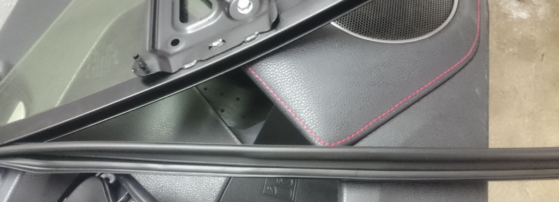

To be honest, I have no idea, even the new seals are barely touch the window compared to the seals of the others cars we have. Even if the seal is fully pushed to the window, it allows water to pass trough. Would it be possible to take a picture on how the scraper seal touches the window when the door is closed (especially at the end of the windows)? It may provide a solution for me.
Will get some pics for you.

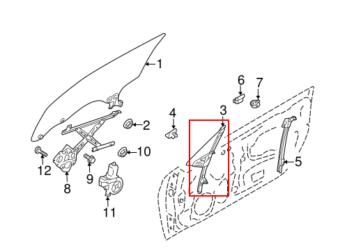

So I was checking prices for the parts and it looks like they are a good bit cheaper from Subaru Vs. Toyota. I also noticed that Subi has a picture of the stabilizer:
This is for sure what is scratching my glass. If I pull the seal back a little and look inside the door I can see the stabilizer and it lines right up with the scratches. I just didn't realize this was the "stabilizer" until I saw the picture of it.

Thanks!
Tried to get pics but can't get one clear enough to be of any value. I think what Ultra said is probably your best bet anyway.

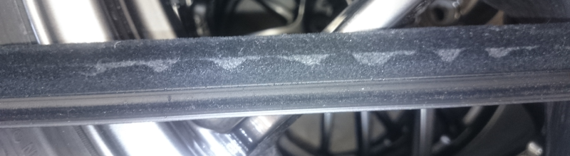

So, after several session of window adjustment and wait for rainy days, I have finally found what caused the problem for me. It was not the adjustment. The issue was that due to the poor design of the whole mechanism, not only the guides collect a lot of dirt but also the front rubber guide of the window (that is part of the small fixed window, see attached pic). Any of these can make the window squeak in rainy days. Unfortunately, soaking with silicone did not help in my case, so I had to remove the fixed window, cleaned the rubber and the window (both were extremely dirty) and problem solved. I used 4-5 shop rags while the rubber got finally cleaned:

Btw, the newest iteration of the water seals (6th maybe?) is still rubbish. There was sleety rain some weeks ago and when I opened the frozen door, a lot of fur was removed from the seal by the frozen water ingress stuck between the seal and the window:
