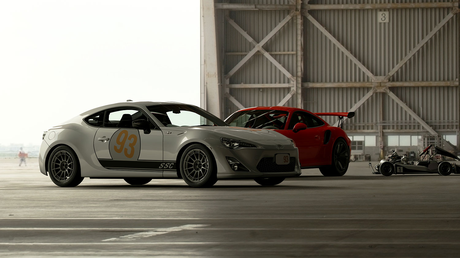

meh. I've moved past wheels. Onto vinyl and magnets...

Love the SSC side graphic.

Are those SSC legal 17x8 NT03? I thought for sure they'd be the super ugly non concave design...
I was wondering the exact same thing...

I was under the impression it was just a photoshop to show decals / numbers.
