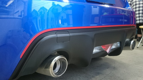

Aint nothin' like OEM...
OEM tS badge and pinstripe... its been years of pining over these stupid little stickers but hey, here we are!
For the pinstripe, note to installers: use a lubricant like clay solution. Spray the adhesive backing and the surface of the bumper then install. You can then move and adjust the stripe and then go back to force the lubricant out.

Looks great!
