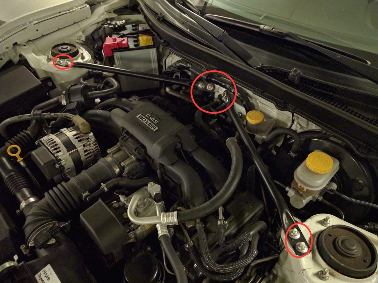

Can you confirm that you mean 11.5 ft·lb and that the bolts in question are those marked in red circles in the attached photo..?

Yea it's the ones you have circled in red. No promises on that solving the problem but it's helped me and I've seen posted around these forums as well.
