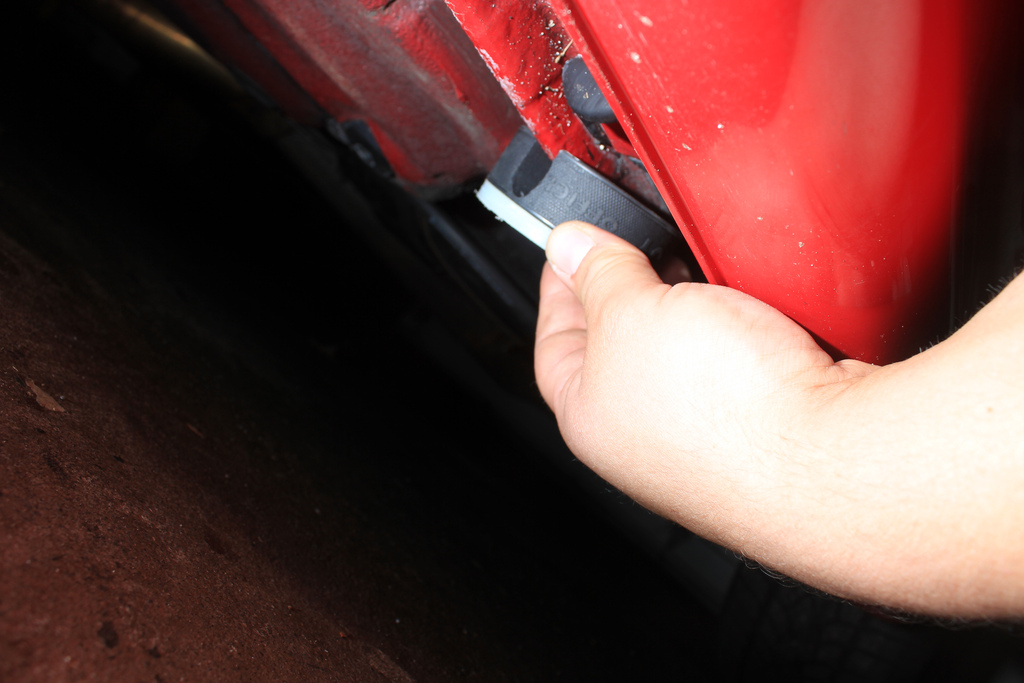

These are not mine.
Just same design, parts are around $8.

I'm biting the bullet and making my own too. Any idea what material was used as backing there?

@blalor forgot the depth of the hockey puck itself.
I'm going to be making one myself soon. Is this hockey puck deep enough? Bought it in an amazon 4-pack:
radroach is offline   Reply With Quote
Old 10-19-2017, 04:10 PM   #22
Posts: 69,838
Since he hasn't been here in two years he probably isn't going to answer.
The official height of a puck is 1" so assuming he also used an official puck (doubt there are many in other sizes) you should be good.

Standard 1" puck, with a 3/4" deep groove milled in them, is what I use. The pinch weld seam will compress the remaining 1/4" of puck some, and they sit fine. I did not use a backing plate...I actually have to stack two of them, due to the deep saddle on my jack.

As stated, just using the pinch weld is fine..
However, make sure the groove isn't deep enough that you are resting on the rockers and the floor pan. (Because, well, that wouldn't be that great of a solution.)
