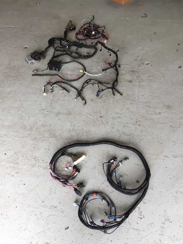

Old harness built by a company a couple years ago vs new plug and play harness. Car ran, but absolutely nothing oem related worked. Now everything works
after the old harness was out, about 30 minutes worth of install on the new harness and did the first start with a bench test firmware. now we can finish the firmware and base map tune in the actual car
