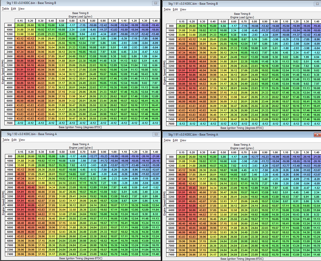

Haha I sure do :P and can anyone tell me if I'm crazy/looking in the wrong spot? The 91 and 93 look that same....
Name:  91 vs 93.png
Attachment 156775
Look at Knock correction Max A table its added to base B to get overall timing then also look at Temp compensation tables

It's all the same, that stinks, I paid $499 because I was told there were tunes for 93 octane, when in fact there are tunes for 91 octane and a tune that is named 93 octane, this is beyond shady.
Attachment 156819
The oldr 91\93 tunes were very similar just a small amout of timing pulled from the uppercrpm area in the 91 tunes.
Looks like they have just gone to a single fuel tune, i suspect tgey wouls be all 93 tunes, ie require 93 for minimal knock and best performance ie IAM at 1 max timing.
When running those tunes on 91 id ecpect the ecu would manage knock by dropping iam to below 1 reducing timing and hence slightly lower power\performance on 91
What does tge release botes say in the download file ?
Oh jist noticed they ard 2017 roms, the tune logic is way differnt in the 2017, its possible undefined tables were changed im not sure have not looked at the v3 tunes are they released to public yet ?
