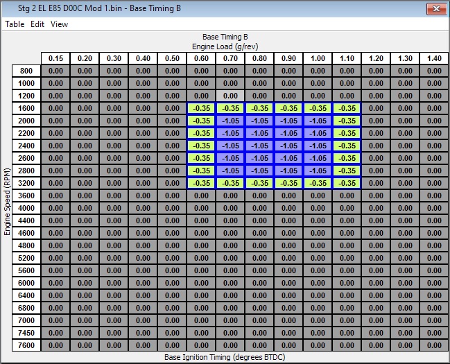

Hey Steve99,
I pulled the timing like you said. I also followed the directions on the video included in the tutorial, and this is what I came up with:
Original timing:
After pulling by -1, and surrounding cells by a little less as suggested in the video. In this case, by -0.35.
Difference:
Haven't meddled with the MAF scaling yet.
Seems to run more smoothly, got about 40 miles on this tune so far.
Here are two data logs after ~25 miles showing no knock:
http://datazap.me/u/milemonger/20-th...=0&data=1-4-12
http://datazap.me/u/milemonger/short...g?log=0&data=1
Could you check this out and see if it's okay?
Thanks so much steve!

Originally Posted by MileMonger View Post
Hey Steve99,
Original timing:
Attachment 153866
Attachment 153869
Difference:
Attachment 153868
cannot really tell much as no full throttle runs . you also need to log Throttle instead of inj timing and maybe Feedback knock FBKC instead of KC learned
steve99 is offline   Reply With Quote

haha its good you have zero fbkc and flkc, this is what you want no knock correction.
by active I meant that that's the type of knock you would see , if their was any.
you have no knock.
all ok.
Its a little rich mid/high rpm. you could do a little open loop maf scaling if you wanted but not rearly necessary
