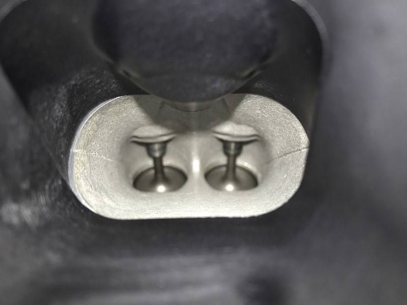

More liters maybe

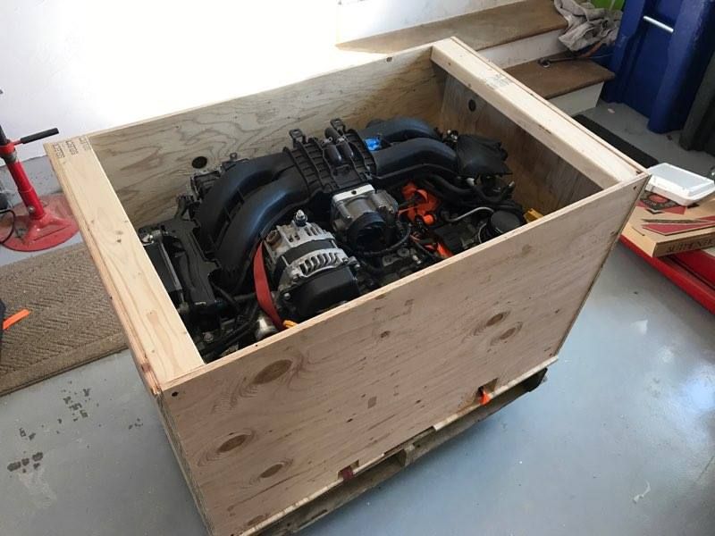

FA20 is sold and ready to go.
The new heart arrived quicker then expected, this is a Ford 3.7 V6 from a '14 Mustang. I came across this brand spanking new one for a steal. 305 hp 280 tq
I'm trying to liquidate all my turbo stuff first so no real quick progress on this but Im excited to have finally picked a motor.

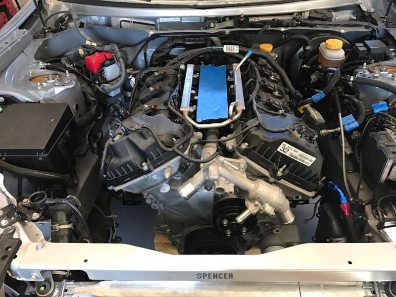

Rough test fit, hit where I expected, plenty of room where I wanted it.

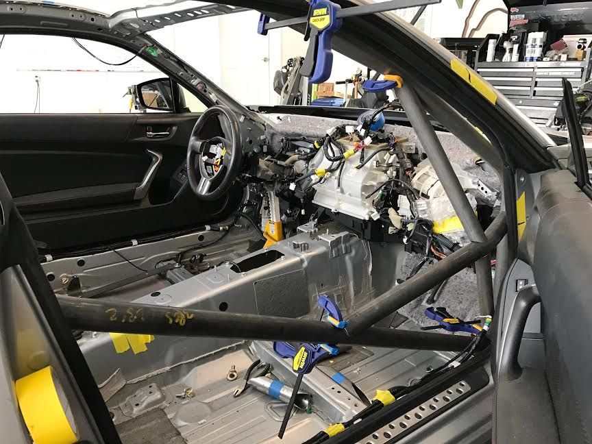

Finally getting back to some cage work. Trying out door bar designs, I like how this is looking.

Test fit the engine and trans, found more things that need to move but its progress.
