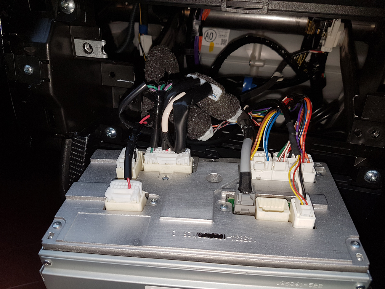

Akuma147 can you make one of these custom harness for me?
I am interested in getting this android head unit, but Joying told me that my backup camera will not work with their harness. As you pointed out you need to down voltage and meet the voltage of the camera and do some other things.
My current head unit on my Toyota 86 GT:

Just follow my guide, everything is written so that anyone with minimal knowledge of wiring can still do it. For the backup camera, you need to get the DROK 12V to 6V converter and wire it exactly as described in my guide.

have you got a higher resolution image of the wire guide, some wires are hard to make out which point they are going to (no offence to your diagram)
Cheers
