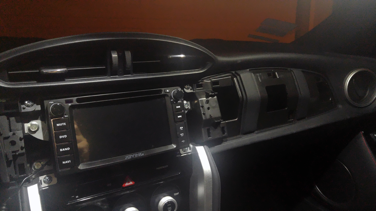

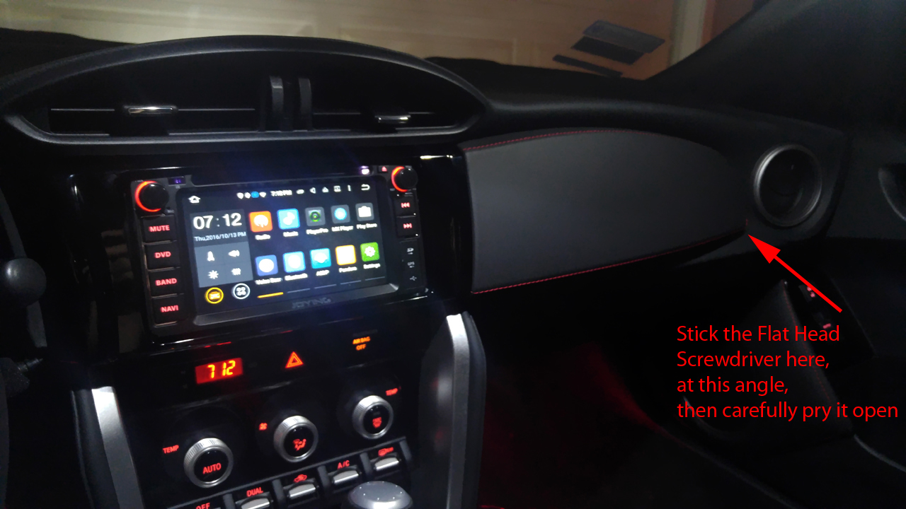

Step 1) Open the dash panel to get access to the OEM Head Unit. Easiest way for me is to get a large flat head screwdriver, and wrap the tip with duct tape so you don't scratch anything. Carefully, but with a little force insert it into the bottom right hand corner of the dash trim. Carefully pry it open and the clip should pop right out. Then you can grab onto the exposed dash trim and carefully pull it out, working your way to the left. It's only held on by little tabs, so it comes out pretty easily. The second piece of the dash trim that covers the HU should also come off as you move left as the pieces are loosely connected. Once off, put the trim pieces in a safe place so you don't scratch it.
Attachment 144874
Attachment 144875

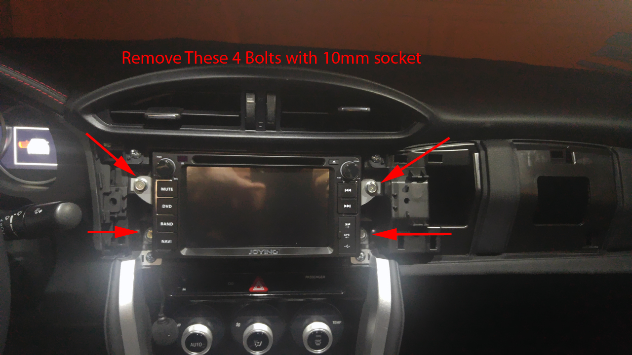

Step 2) Removing the OEM Head Unit. The HU is held on by 4 bolts. Remove the 4 bolts using a 10mm socket/wratchet. Once the bolts are off, carefully pull the unit out. Take out all connectors that are connected to the HU. This should be self-explanatory, just be careful when taking each connector out. Some of the connectors has a little tab you need to push down and then you can pull them out.
Attachment 144876
