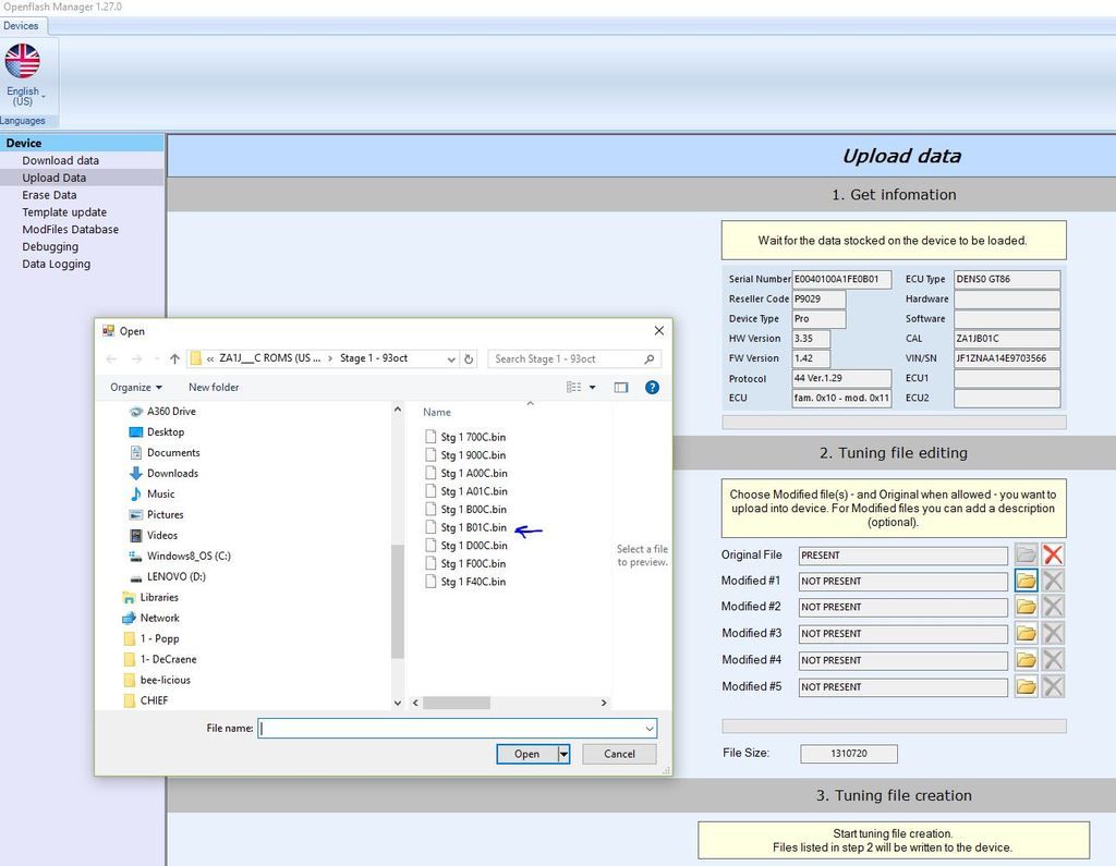

Hey guys, I bought a used OFT and Im having an issue uploading OTS maps to it. It married to my car OK, but did not have any maps on it, even after teh update, not sure if that's normal, so I downloaded the maps separately, and I'm trying to upload them to the OFT. I'm selecting maps that match my CAL but I still get an error saying that its the wrong map and it wont let me upload the map to the unit. Anyone have an idea of what could be wrong?

I uploaded the original map. This is the map that the OFT pulled from my car after initial setup.
WHen I try to upload more maps to the OFT with the same CAL ID the error message says that the file is not compliant.

Ok it looks like you car has been flashed previously, most likely with tactrix.
The rom is not stock. and its been calid adjusted.
You should be able to load OFT B00C roms ok, these are the same tuning wise as B01C anyway.
You are the man! Thanks Steve, like you said, I was able to load B00C roms, I got a warning saying "The checksum of the file has been corrected". Hope thats OK and wont mess anything up.

Your stock ( non stock in fact) rom was actually a b01c hacked to look like b00c so the oft definition for a b00c should work on your original rom.
Just go to the wwww.openflashtablet.com and download the tunes 2.076 i think in the zip file will be the roms and defs use the b00c def should open but read the romrsider tips link beliw in signiture
