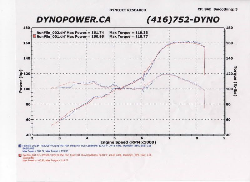

Completely stock NA 1.8L I4 engine.

I'm guessing your 2ZZGE? VVTL-i high lift profile is kicking in at 6000 it looks like.
Edit: You a transplanted Canuck? Or just picked a random dyno chart?
:party 0030:
Yeah. Not my car, but from another. Same idea though.
Thought I'd just leave that there.
What?? lol
It's not my photo, but I know it's a stock run from the guy that posted it where I go to.
