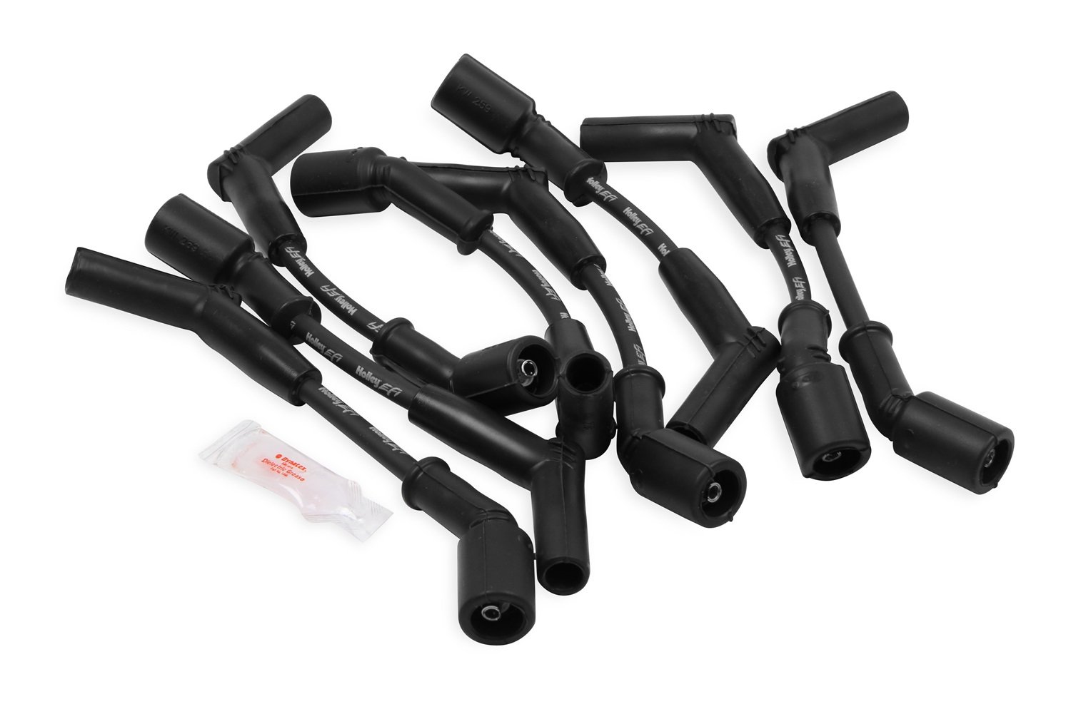

On the first picture you can peek at the Sikky Oil pan already installed.
On the second picture,
One of the plug wires hits the header. Is it possible to remove the aluminum spark plug boot and that makes the spark plug cable to fit? Is the boot necessary for OEM cables but not needed for aftermarket cables? Any ideas @DustinS

Are those factory spark cables?
Yes, the aluminum spark plug boot is what pushes the wire out. So I assume with the Holley EFI wires, I can ditch the aluminum boot (the Holley EFI cable itself is the boot over the spark plug). Thanks for your help always!
