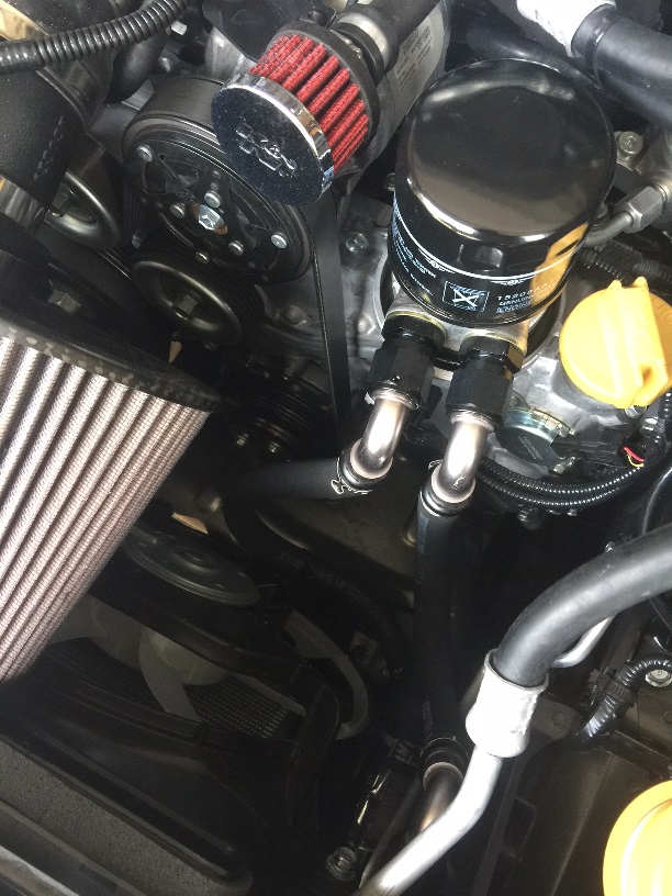

Here are a few shots of my Jackson dual radiator installed with my long headers and the edelbrock.

this kit is all fun and games until you install a turbo kit and try to clear the AN fittings on the sandwhich plate LOLOL

yeah, turbos are just soo complicated

Anyone using a lower profile oil cap to get more of an angle for the oil lines? I'm looking at trying the Prova as a possibility as it seems nearly flat.
