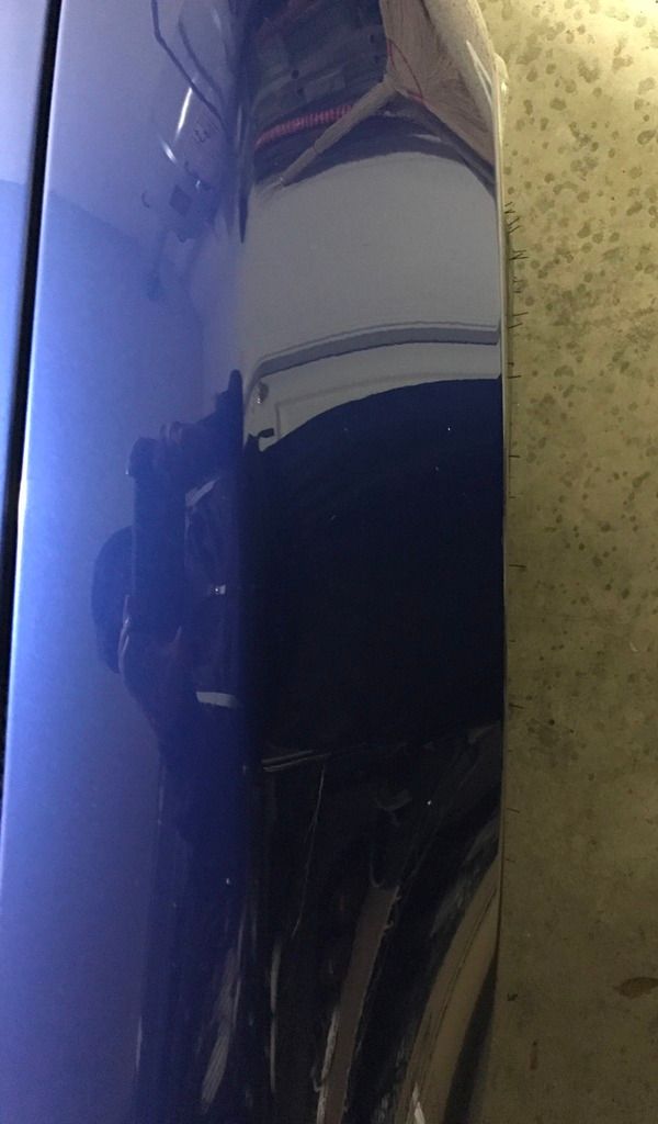

For those wondering what having the 17x9 +35 with 245/40's on -2.0 camber up front....0 toe. Steering wheel was straight for the shot. I'm dropped about 1.2" from Tein Flex Z's. Everything else is stock. No additional camber bolts and what not.
Note the angles of the shot. The fender doesn't go straight down...it's angled...you can see how the tire tucks in relative to the angle of the fender's flat part.

Awesome, thanks for this man. That looks good.
