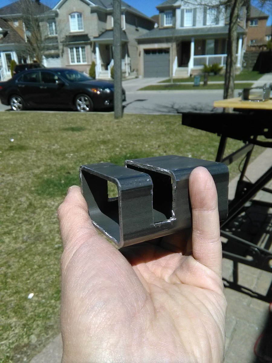

So here's my take on it. If you look at the factory emergency jack, the pinch weld is used ONLY to locate it inboard/outboard on the car. The jack itself doesn't even touch the pinchweld vertically. All the weight is supported by the pad just inside the pinch weld.
The pinch weld is used only because it's easier than trying to correctly position a jack/jack stand behind it.
I think that's the REAL jacking point, not the pinch weld. in fact, I believe this enough that i made this: Name:  2016-04-20 18.04.22.jpg
I don't recommend turning the jackstand sideways though....that's just asking for trouble when it slips off.
I think that's the REAL jacking point, not the pinch weld. in fact, I believe this enough that i made this: Attachment 148748
Those look great. If only they made jack stands in that shape.
Do you place those on top of your jack stands and let friction keep them in place?
I know there are some adapters out there for the jack itself to lift from behind the pinch weld, but I'm skeptical on placing those on Y shaped jack stands.
I'm actually one of those daredevils that don't use jackstands and just lift the car with the jack only..... =( but mostly because I only really do tire changes and not much more.
If I were to make these fit on a jack stand, I'd probably weld on some two inch skirts so that they won't slide/pop off the stand head?

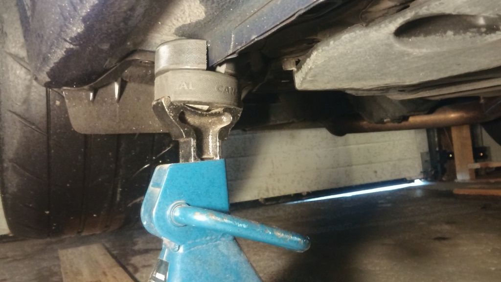

Made these out of hockey pucks so I can protect my rockers.
I have the similar setup. Bought hockey pucks from dollar store and made these.
