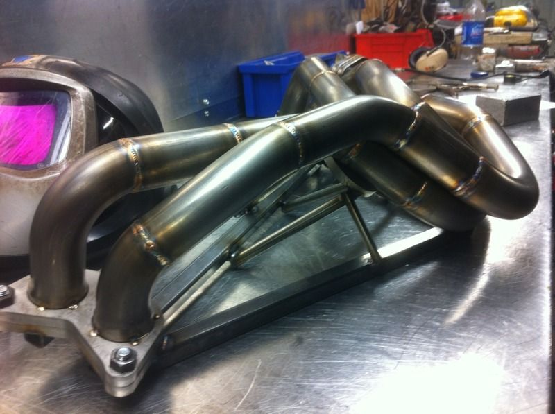

We have done an intake. Haven't had enough time to do much testing on them, we built three designs and did some preliminary dyno testing of them but then the card had to go back to the owner before we could really dig into it. Then we switched gears to the header as soon as it came back. Tomorrow we go back to working on the intake designs.
Can't wait to see what the new catless header is capable of. The catted header that made those power numbers listed earlier on in the thread was really a compromise. There is an optimal length for the secondary tubing on the Tri-Y design, and inclusion of the catalytic converter required that we shorten that by a substantial amount (~5"). So here's the optimized catless design:
Just got done wrapping that design up (literally and figuratively), and plan on getting it out on the road for some preliminary tests here in a few and then continuing that testing tomorrow and fianlly taking it to the dyno in the AM on Friday, then back to Tainen for a dyno day he'll be attending hosted by @virtual_bob in Auburn, WA this weekend.

Header system looks like a Aliens face hugger.

25 miles put on it and 15 extra minutes of idle time in two key cycles and no CEL so far with the catless. This certainly doesn't mean that it won't throw one intermittently. I've certainly experienced that in the past - 4 months no CEL, then one pops up, disappears a week later only to resurface 3 months down the line, etc. Those are the worst.
Seems like it's breathing better with the catless vs. the catted header. A little louder, but much smoother rev. Kindof a wash as far as sound goes.
It's evident to us that many of our customers are going to want a quiet exhaust on these and we will be considering our options on this. Simplest way is to offer the suitcase option that we offer on the WRX hatch. I hate those things though, so we're also evaluating methods of using our center-offset or offset-offset canister mufflers. Personally I think the exhaust sounds wicked as it is right now when it's at full-tilt boogie (and you can run around town with almost no exhaust sound at all currently), but if people want quieter, we'll certainly offer it. The other option would be to offer our midpipe with a more aggressive than stock center resonator. I just hate selling parts that don't make additional power if we can avoid it.
And yeah, D, Friday. I'm going to call Aaron and beg to get it in tomorrow. I just have to know if it's making more power or not and if so, how much. Certainly seems to be, but I thought that after the track day and it was a wash. Anyone know of a good butt-dyno calibration service?
Going to throw our short ram intake w/ billet MAF on it tonight and take it out again in the morning and see how it behaves with all the exhaust opened up.
