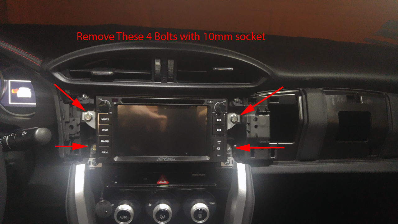

Step 2) Removing the OEM Head Unit. The HU is held on by 4 bolts. Remove the 4 bolts using a 10mm socket/wratchet. Once the bolts are off, carefully pull the unit out. Take out all connectors that are connected to the HU. This should be self-explanatory, just be careful when taking each connector out. Some of the connectors has a little tab you need to push down and then you can pull them out.
Name:  03 - Bolts.jpg
