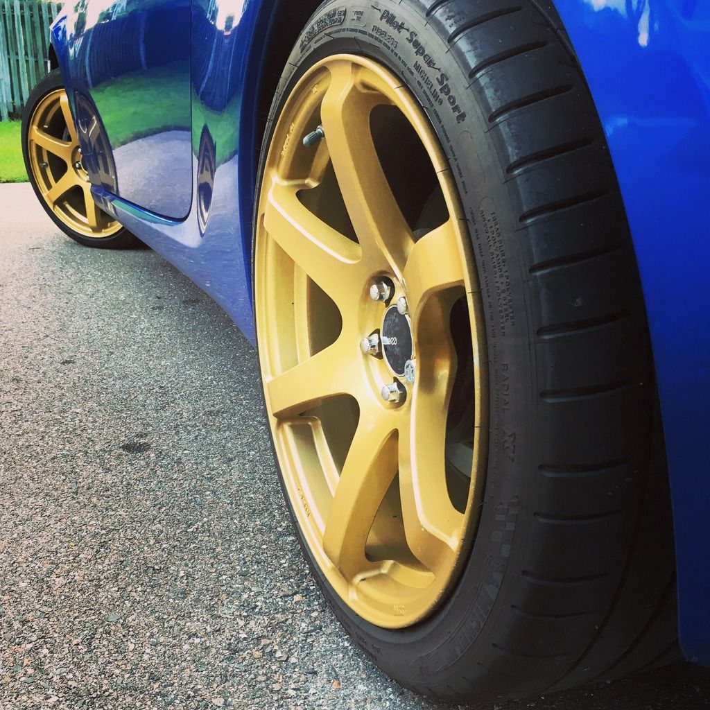

I'm on Enkei T6S 18x8 and 18x9.5, they have a nice concave look.
