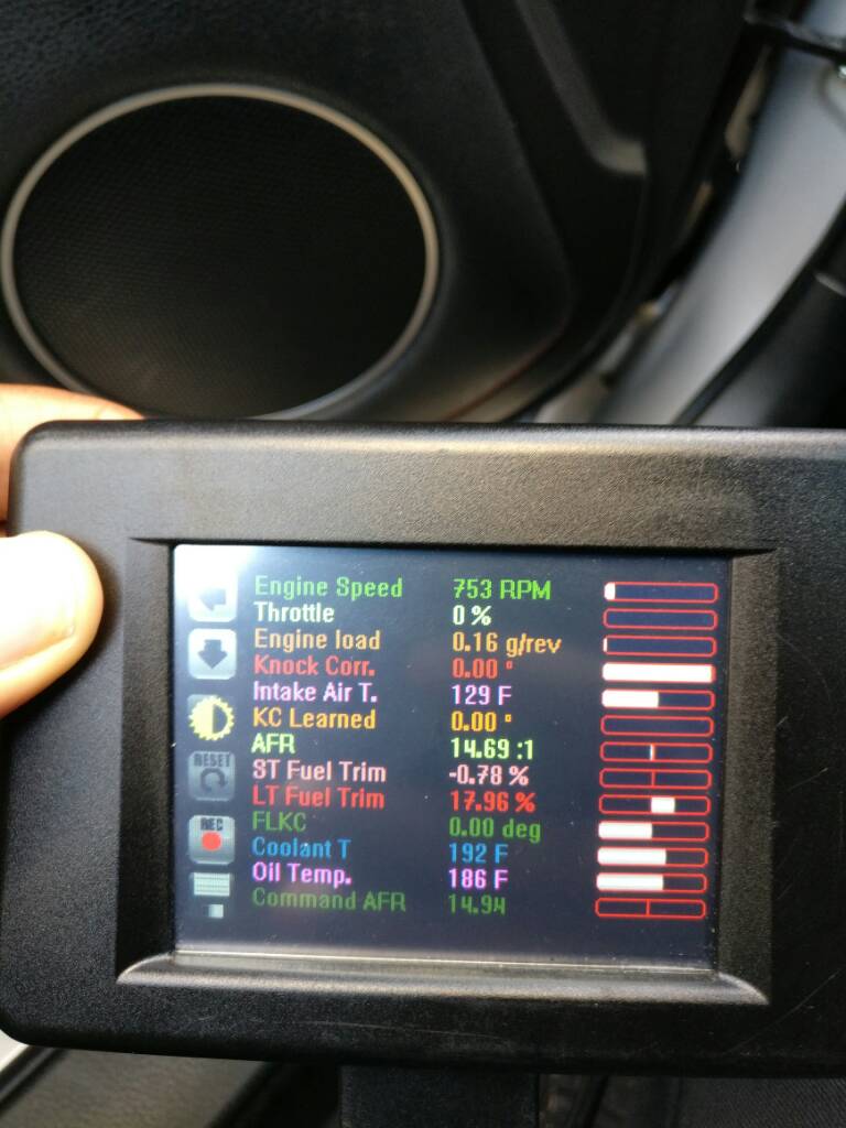

I flashed the E85 tune from shiv again just to make sure. First pic is after a rev and second is idle

Originally Posted by ImDatSlaya View Post
Attachment 147183
Mate there is definitly something wrong, id say you still jave petrol tune in ecu with e85 in tank, or big exhaust or intake leak.
reflash the e85 tune

I did already. I took it straight from the email they sent me and cleared all my tunes from the OFT. I did a smoke test at work and there's a small leak from the front pipe to overpipe but that's it. 2 things I forgot to mention. I also have the Perrin inlet hose and drop in filter.
Sent from my ONEPLUS A3000 using Tapatalk
inlet hose or drop in filter wont effect maf scaling.
what were the fuel trims like on petrol ?
Also what are the LTFT like through out the rpm range when driving ? are the ltft always high positive even at 3000 rpm and above
best if you log to a file and post it up to www.datazap.me much easier to see

This was from this morning on the highway(average speed 85mph).I did double check and I am on the E85 tune. Im replacing the gasket between the over pipe and front pipe today.
ok if lftt and afr are good at 3500 area you look like your on the correct tune
looks like the ltft is only high positive at low rpm and idle
this usually indicates an exhaust air leak at or before the front o2 sensor

High positive LTFT at low RPMs but getting less positive with RPM increase is a sign of unmetered air getting into the engine- air leak between the MAF and the intake mani. That looks like a vacuum leak.
At idle your total trim is over 17%, but at 3619 it is near 0. Positive fuel trim means that the engine is requesting more fuel because the car is running lean. Your AFR is running to high (lean) so the engine is protecting itself. A vacuum leak always lets in the same amount of air, the orifice that is leaking doesn't get bigger with RPM and is very constricted. At low RPM there's a lot less air entering the engine so that small amount of air through the vacuum leak is relatively large (relative to the small amount of air entering). But at you increase RPM you also increase the amount of air entering the engine so the vacuum leak becomes relatively smaller to the large amount of air coming in. So the fuel trims need to compensate less at higher RPM.
yes for sure intake leak will produce similar symptoms.
with exhaust leak 02 sensor sees fresh air as between exhaust pulses their is low pressure and air can get sucked in , thinks car running lean, adds fuel via fuel trims to compensate. as per intake leak its usually more pronounced at idle and low rpm.
