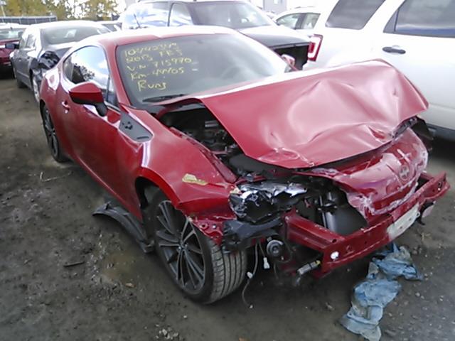

Best deal will be had if you have a friend with a dealer license that can buy at auction. There are "retailers" flipping them but as most have said on here already they want too much to make it worthwhile.
I set a strict budget for myself and bid on 4 cars (all at Impact Auto) before winning one within my budget and I'm very happy with it. No structural damage at all and it will be on the road soon. This route isn't for everybody as there is inherent risk but this is my second one and would do it again.
Here's some before and I'll post some after when it's done.
Looks like one small dent in the crash bar and some body panels. Good score if the price was right. Surprised it wasn't rear ended with those overly blacked out tails.
Yep, your bang on. The MAF (and the airbox) and 1 of the oil control valves got smashed. The rad got punched but surprisingly the fans and a/c condenser survived. The taillights are brutal. They are getting restored and all the red plastidip in the interior is going too.
