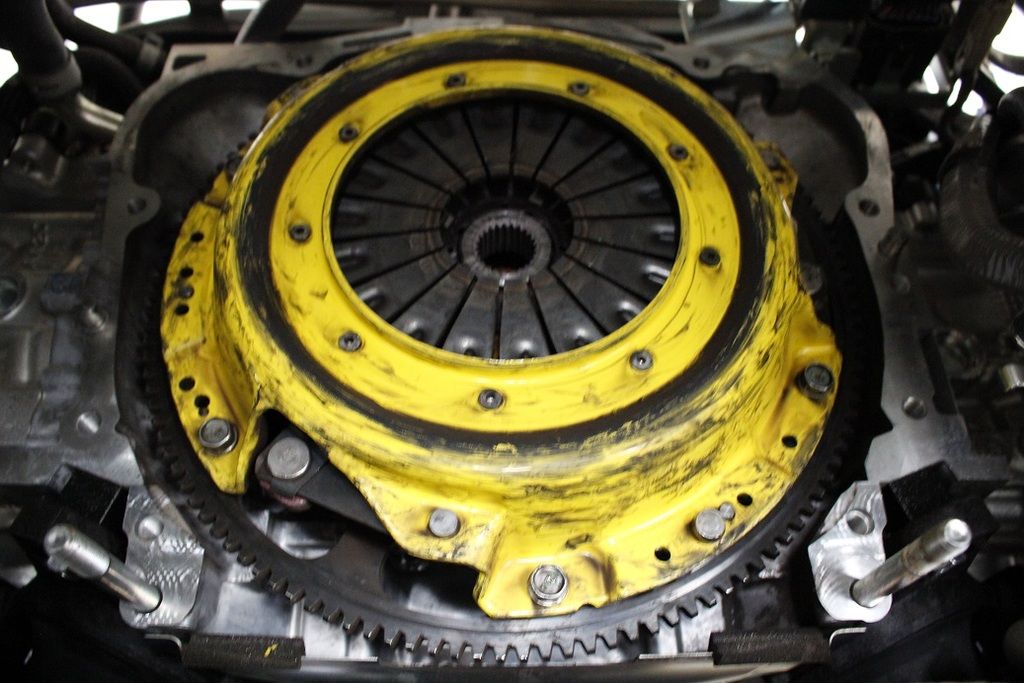

Had some free time while my computer's hard drive took a dump on me, and I got the upgraded motor mounts in the car. With the oil drain in the way for the driver's side, I'm really glad I had the transmission out at the same time.
This is what happens when the trans/engine plug on top of the engine gets hot enough and drops into the bell housing. Didn't hear anything, nor did it ruin drive ability or operation. I was just checking up on the clutch fork and looking at the TOB for some quick routine maintenance and testing and saw this. Cleaned most of it off with a bit of brake cleaner.
*I highly recommend removing it if you're tracking the car or are FI. It will fall in and it will make a mess.*

Are you talking about this piece?
Is there any issue with removing it?

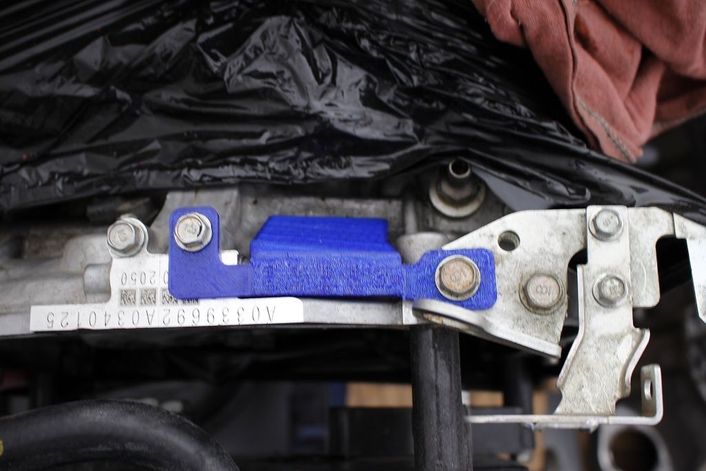

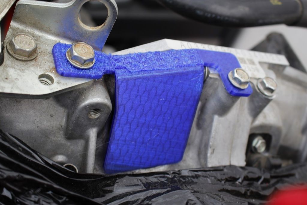

Got a bit of design work done over Thanksgiving weekend in between a lot of shipping. Designed and rapid prototyped a bell housing cover for the FA20.
Design
Slicer screenshot (creating the gcode for how the printer will print)
Design on mock-up engine we have laying around.
Thanks,
Eric

Originally Posted by flixonase View Post
Hey Eric,
I'm using my car for the track only. Never had the engine or transmission out of the car so I have no idea what is shown in the pictures... But I take your recommendation seriously.
Which part needs to be removed? Can you please elaborate?
Thank you very much!
Look at my post right below his, I circled it. You can see it from the top of the engine in the very back under the hood. It's comes out alarmingly easily, just a rubber piece sitting in there.
You can't see it in this picture but this is where it's at.
