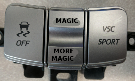

Originally Posted by markitect View Post
At the very least if you can replace the MT buttons with the AT ones, with no rewiring, you will just have two buttons that are not connected to anything.
I feel like you would need a magic/more magic label for that.
http://catb.org/esr/jargon/html/magic-story.html
markitect is offline   Reply With Quote
I like how you photoshopped out the scratches on the VSC button as well.
I feel like that is the perfect button set up for map switching.
