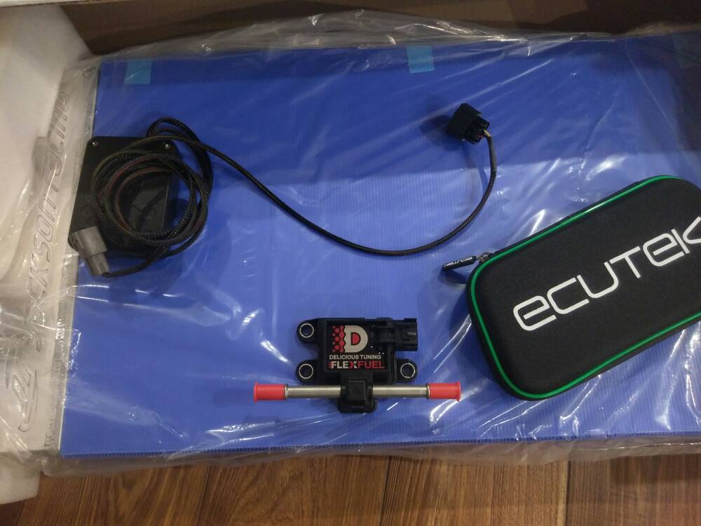

Originally Posted by Reamer View Post
Attachment 145464
Got a date with PRT Performance for the 17th, doing prep work for the JRSC.
Sent from my HTC 10 using Tapatalk
My car will be in on the 15th.
