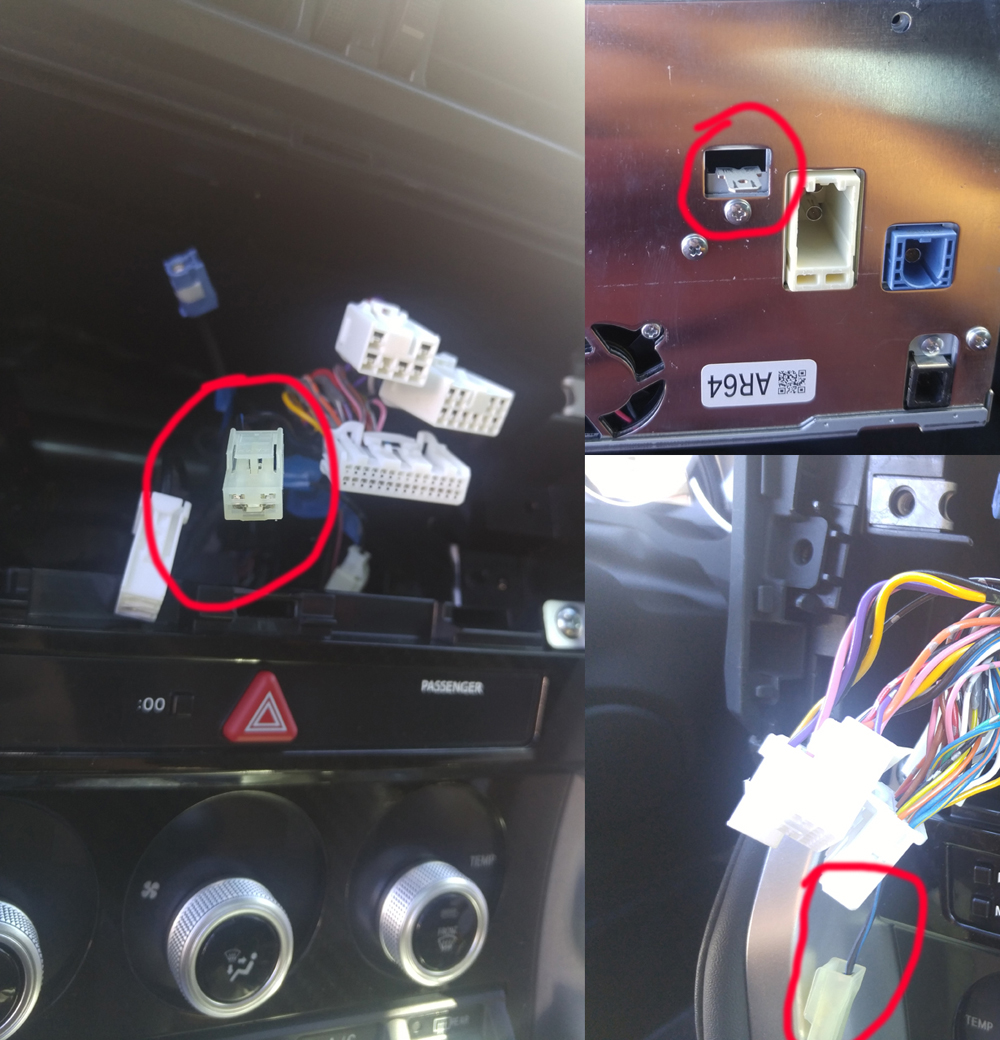

I'm going to attempt to install the Joying 5.1.1 model today. Since the 2017 BRZ has steering wheel controls, him hoping somebody can help me identify which wire it is. I have some suspicion as to which one it is, or maybe I can just disconnect it and see if it works or not.
I'm not sure what wire this is. It's black and blue and attaches to a metal bracket on the OEM Head Unit.
Name:  Unknown Cable.jpg
I'm thinking this is the steering wheel control cable. It's a small pink wire that is taped to the 28pin OEM harness
Here is the actual 28pin harness. Looking at previous posts, pins 21-24 were empty. As you can see here, 21-23 now have wires connected. The pink wire also shows up, along with blue/yellow and light green. I'm thinking the pink is the steering wheel control wire.
I'll go ahead and test it out, but if anybody has any insight, please feel free to share.

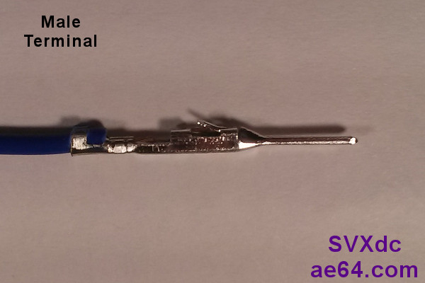

There's a chance that the terminals on those 3 SWC wires in the Joying's 20-pin connector are the same type that Metra uses on the AX-SUB28SWC. If so, you can extract the SWC terminals from both harnesses, and transplant the Joying's wires directly into the Metra 28-pin shell.
You'll need an extraction tool.
I straighten a small paper clip, then flatten the last ~10 mm of the end with a hammer on an anvil. File the tip so that its cross section is just barely small enough to fit through the rectangular extraction hole (above each terminal). File off any burrs and sharp edges.
Or if you already have something that size, you can use it.
I don't recommend using a straight pin -- it's too easy to go off target and impale the plastic shell.
Insert your extraction tool about 6mm deep into the hole. If you get it right, you should be able to tug out the wire without much effort.
Typical male terminal used in Metra AX-SUB28SWC and other harnesses with similar sized pins:
Name:  025 male terminal.jpg
What you'll be doing with the extraction tool (shown with female terminal):
Name:  Extract pin Reverse.jpg
