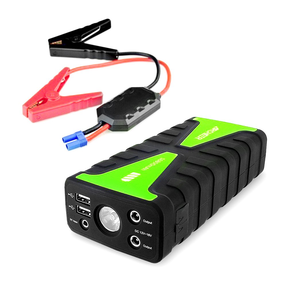

Anecdotally, I've had to change my starter battery once at about 18 months from Powersonic PSH-12180 to Odyssey PC-680. As a precaution, I started carrying a portable jump starter (like this one, but any brand will do, the more mAH the better) a few years back. They're compact work exceedingly well and make sure you can get things going in a pinch.
https://www.amazon.com/dp/B017CMMRAE?psc=1
