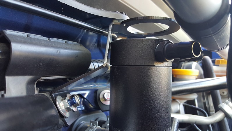

I just ordered these this past weekend and attempted to install it today but ran into a small problem. The catch can does not fit with the STI Flexible Strut bar. The 2 fittings get in the way.
Can you provide another angle of your engine bay.. I want to see if there is anything I can suggest...
I had to modify my bracket to work with my Beatrush tower bars.
Maybe something like my setup will work for you...
I took some several other pictures but Im not sure if these will help you much, I can go out to take more photos if you want.

If you can't make it work like I did then another option is create a whole new bracket or cut the existing one and rivet it or weld it back together shorter.... perhaps changing the angle a bit might help as well.

I've just received my CC only to read through the thread and found that the bracket is also unable to fit underneath the multiple brakelines that we have on RHD 86.
The sticker on the bracket package was dated 3th May 2016. Please advise @Mishimoto.
@Mundy , did you ever received a solution to your issue?
Top part of the bracket rubbing against brakelines. Unable to level the bracket.
Bracket and plastic cover in contact. Cannot force into place. Removed bolt will not fit.
I should also add that the bottom half of the catch can is near impossible to unscrew. Am I suppose to find a table clamp to remove it?

@Pineapple I know you expected it to just work out of the box as do I when installing my new mods. I ran into a fitment issue once I installed my Beatrush tower bars... Since I was no longer able to install as directed, I came up with this work around... perhaps it could work for you as well...
__________________________________________
How I modded the bracket...
Hopefully this helps you out. Cheers!

In your case, your own mods prevented the bracket from being installed as intended, otherwise it installs just fine.
My point still stands though as I have no mods that would hinder the installation, yet it still didn't fit. With words like "No cutting / modifications needed"in their advertisement and I mean what reasons would I have suspected that it didn't fit RHD when it clearly states "Fits LHD & RHD"? It's just plain misleading.
I chose their kit because it looked straightforward and that the shaped tubes keeps the engine bay tidy and more importantly, it's suitable.
