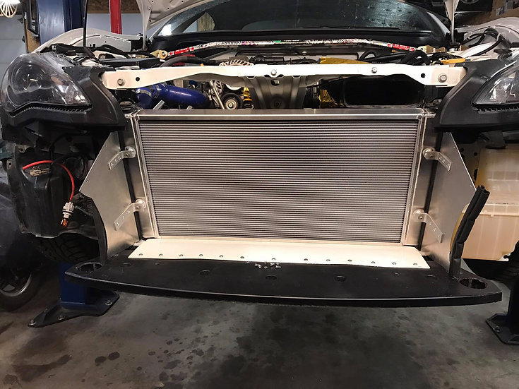

We are looking to gauge interest in producing a unit like this for the market. We produced this piece for our own shop car because we’re cooling snobs and we wanted the best possible cooling solution. Nothing currently on the market fit our needs, thus we set out and designed/built our own.
CAD design
Rear shot
Front radiator shot
Comparison with OEM
Installed shots

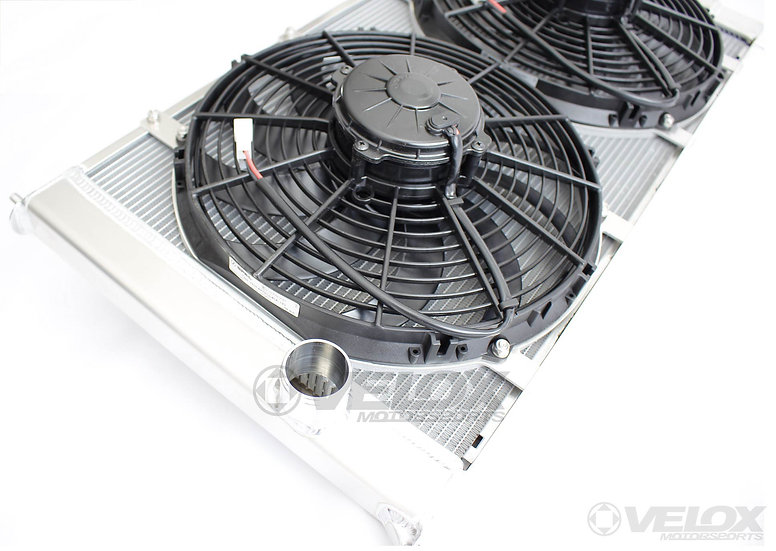

What’s with the fans?
-The fans are installed directly onto the radiator surface itself. This serves various functions.
-Reduces overall install thickness
-Increases cooling at speeds. A fan shroud, while great at improving flow through the radiator at speeds under ~20-30MPH, actually hinders flow at higher speeds. This actually causes both an increase in vehicle drag, as well as reduced performance from blocking flow. This is even more prevalent with thin shrouds that are box style, OEM fan shroud is quite nice.
-These fans are NOT low profile units. They are high-performance SPAL units which are able to pull significant CFM through dense cooling stacks, something low profile fans struggle with.
-These fans can also be removed for reducing weight on the spot. Two nuts and the whole fan assembly can be pulled off. The fans are two individual assemblies and can be removed without removing the hood latch support.

Solid work, will there be a port to add a temperature probe?

1) The shop car has our hood louvers. I did not notice a reduction in water temperature with the OEM radiator when I added the louvers (still NA at the time). However, reducing pressure (and heat) in the engine bay most certainly helps the radiator do its job. I can't quantify how much it helps from logs though.
2) We have plans to develop an oil to water unit capable of handling a decent amount of heat. However, and we could be very wrong here, we thought it best to produce this as a stand alone unit. This increases the choices the community has.
That can easily be added.

1/8" npt port was added to this one

Originally Posted by Vracer111 View Post
What is the approximate weight and fluid capacity difference between stock and this unit? Does the A/C evaporator core still being upstream have a major impact at all on the efficiency of the radiator or is it really minor?
I didn't weight it, this will be heavier than the OEM unit for sure. It has slightly more fluid volume (OEM is a 16mm core, this is a 27mm core, ~ the same tube spacing) and is constructed of all aluminum (plastic is lighter). This unit will be lighter than all the thicker offerings on market, in both dry and wet weight.
Yes, the AC condenser most certainly affects cooling.
-It increases the temperature of the air the radiator sees.
-It adds restriction to the overall cooling stack, aka less airflow through the unit.
Originally Posted by churchx View Post
@VeloxEric: have you thought on making it dual rad incorporating oil rad like Jackson Racing one?
Also i wonder which design should be more efficient, like in your pics with all the rad area uncovered, or one with shroud on area not covered with fans?
BTW, how about as another product - making shroud kits for front of rad (preferably universal, to fit most rads) to smoothly direct all the air hitting front rad grill opening to rad?
We have, but as stated earlier, we would rather offer each separate so that end users can pick and choose which unit he/she wants to run.
No shroud is more efficient at high speeds, fan + shroud is more efficient at low speeds (typically under 30 MPH).
Front shrouds are typically referred to as duct work. I created some specifically for my build which actually made a decent impact on cooling at speed. While making them, I made the decision that I couldn't create a kit that would work for everyone, it's too kit/car specific. So we will not be creating anything like this for the foreseeable future.
All of these photos and more are located in the Velox Shop BRZ build thread... http://www.ft86club.com/forums/showt...=101812&page=6
Looking great Gordon .
