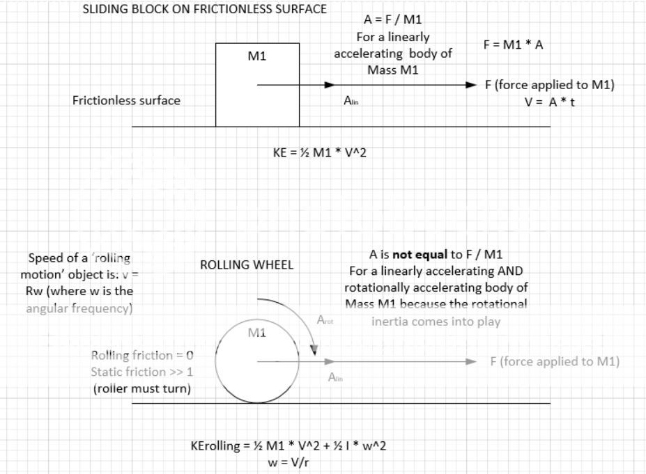

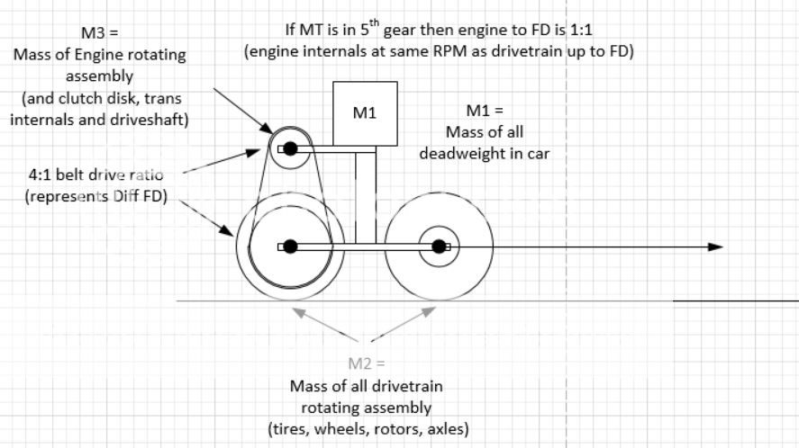

Originally Posted by nova.86 View Post
I'm excited for Mechanics in the Fall, it's gonna be fun when we take everything we learn halfway in the semester and then rotate it lol. Centripetal forces, torque, all that good stuff.
@nova.86
Here are some diagrams and problems to work with in your Mechanics class (assuming it is dynamics and not just statics).
The first diagram shows the #1 most basic diagram of a mass sliding on a frictionless surface.
Just about anyone has seen that one.
The second diagram is actually more complicated than most can do the calculations for but is still considered basic.
It shows a mass to be accelerated, BUT since it must roll to accelerate it has a component of rotational inertia that must be compensated for to know velocity based on applied force:
The 'R' is the radius of the wheel
This diagram is incomplete but shows a simple model of a vehicle system.
Once I get it done, we can plug in actual numbers for vehicle mass and rotational mass to determine how big a factor small changes in rotational mass has on the overall system:
I have also started trying to model all of the key rotational objects in our cars in Solidworks (I start with Onshape because it is free) but that will take me a long time to build a model worthy of discussion.
People who actually operate chassis dynos on our cars probably know a value we can use for total system rotational inertia as the dyno provides a calculated value following the pulls.

Actually it very much is. Torque = Nm (Force * distance) = mass*acceleration*distance .
Ahh, I see now.
Above, I believe you are talking about using an inertia dyno to determine the HP of a 'powerplant' (engine or chassis dyno).
In this case the machine measures the acceleration of the system to determine the output of the powerplant.
So they are using the known characteristics of their dyno (the rotational inertia) and essentially a stop watch the measure the amount of time it takes the poweplant (outputting on unknon torque) to accelerate their known inertial mass.
They then calculate the torque required over the measured time to obtain the RPM of the inertial mass.
In fact to calibrate these inertial masses all you need is a small known force over a very small rotation and observe the motion.
They do this to determine the average torque applied over the duration of the 'run' (and therefore the HP) of the power plant.
New variable load dynos can apply enough of a "brake" to keep the engine from being able to increase RPM while the torque applied to the brake is measured at a constant RPM.
The data acquisition system is just so fast that the system does not need to "pause" noticeably at each sample point.

The pulley won't make power/torque, but it can reduce the system's "resistance to acceleration" as you put it, hence it may result in extra power at the wheels.
5hp? god knows. Needs to be measured.
Again, sorry, that is in error.
Removing mass from the pulley WILL reduce the 'inertia' of the system (resistance to acceleration).
Some of the inertia that is reduced is in the overall rotational inertia of the rotating assembly (a VERY SMALL percentage of total of the rotating assembly)
Another piece of the inertia that is reduced is because you removed weight from the car as a whole.
That second piece of the overall car's inertia is a far larger percentage than the rotational piece.
So it does not "result in extra power at the wheels".
It results in "less total mass" and with the exact same power at the wheels, will accelerate faster.
