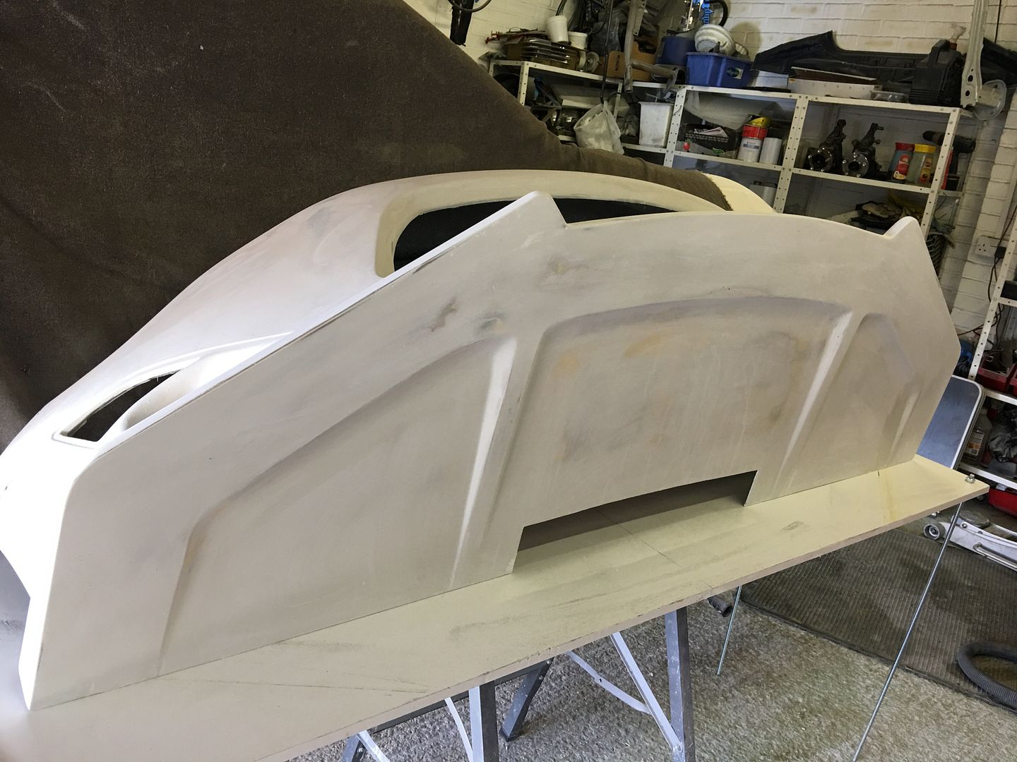

Heres a shot of the front bumper buck as it sits today. Still not finished, but getting there.
Rads and fillets still need to be added.

I've been quiet for a while but I've been busy. The front bumper Buck is nearly done, here's a teaser shot of the underside.

Here we have the bottom finished off and smoothed out. Mould making is getting ever closer.
The top side is also getting there now with its big mouth and filleted and rounded corners.
I now need to fair the RB spat in, cut it about to suit the taller wider arch then we're away!!
Hope you like it.

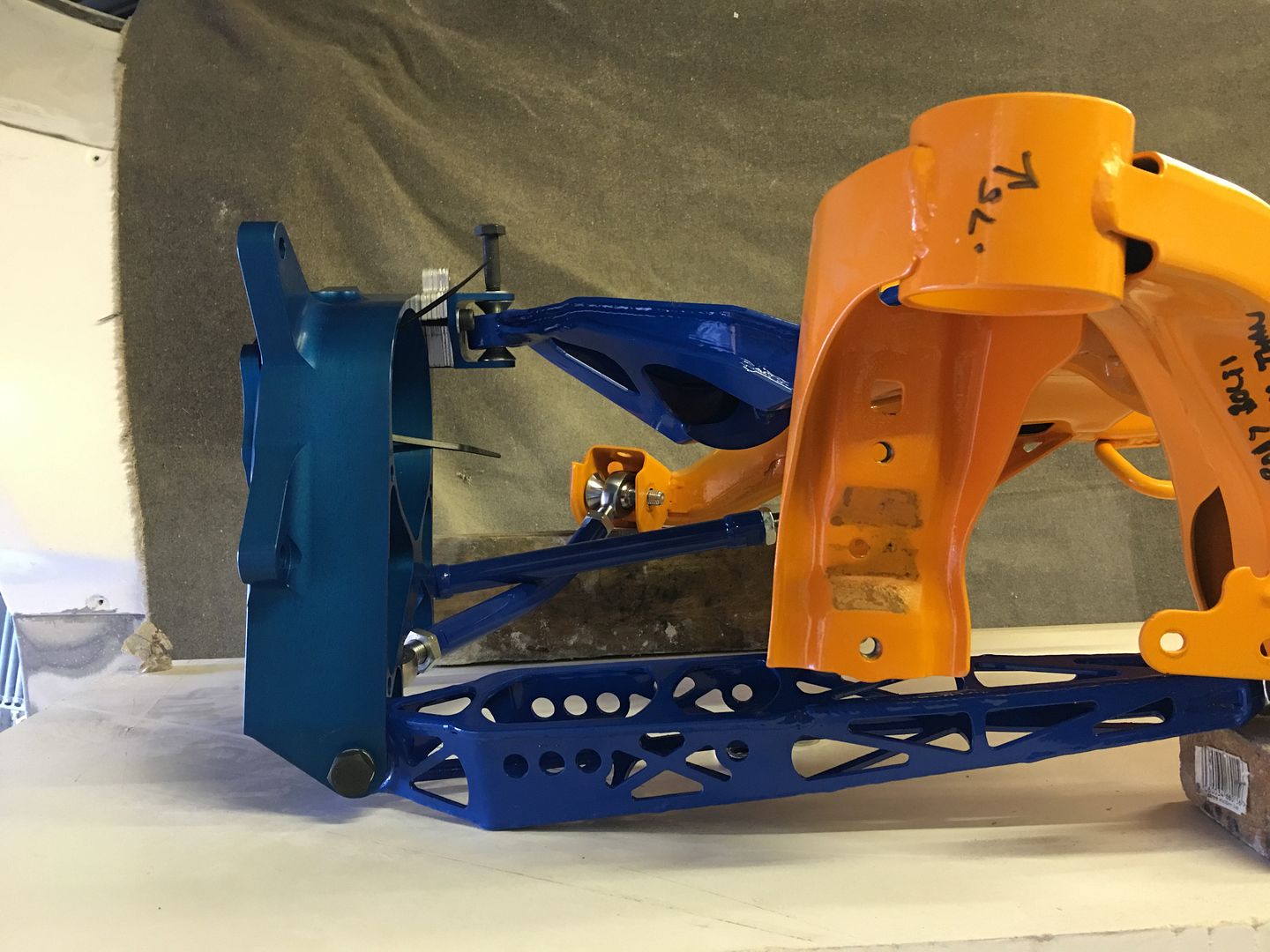

As promised, I have finally had a look at the Wisefab suspension tonight.
I will be doing a full review, which will be unbiased, so keep a lookout. Those of you who know about the issues with the rear end geometry will appreciate the review.
As a teaser, here's a pic of the left side set up on the bench. Believe it or not, this is how it sits with a drop of around 40mm.
Pretty good eh!!

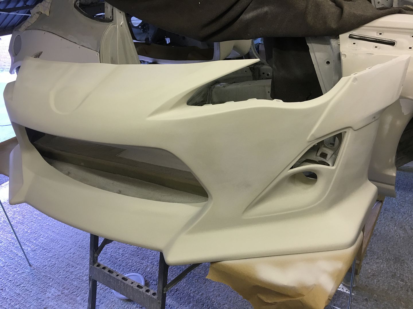

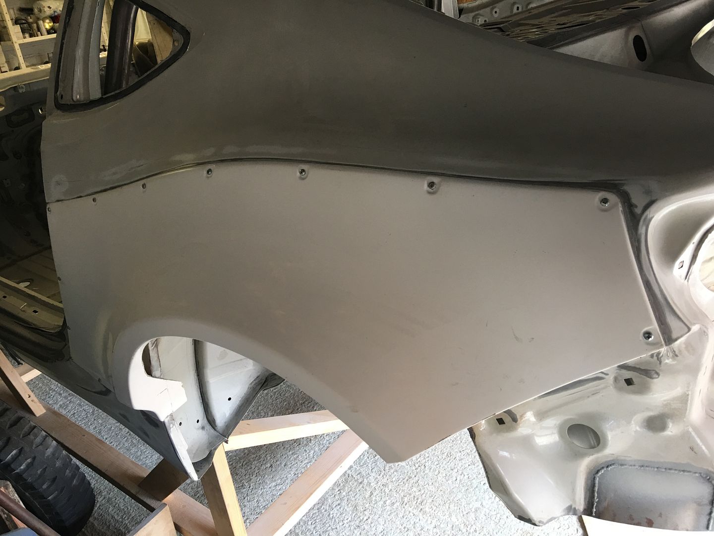

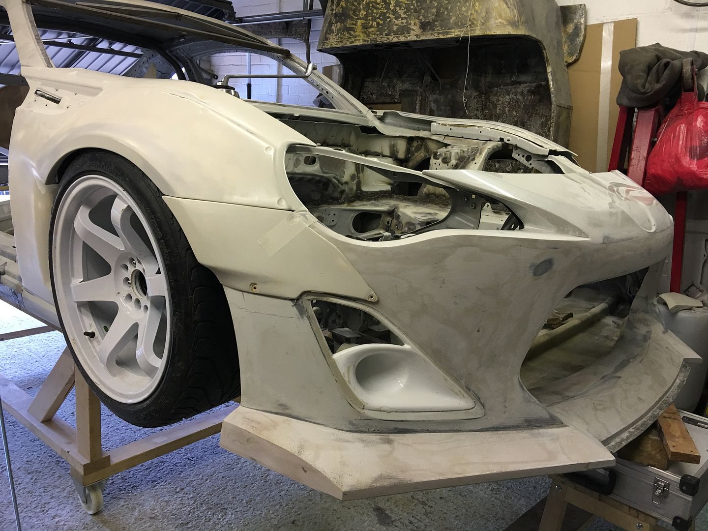

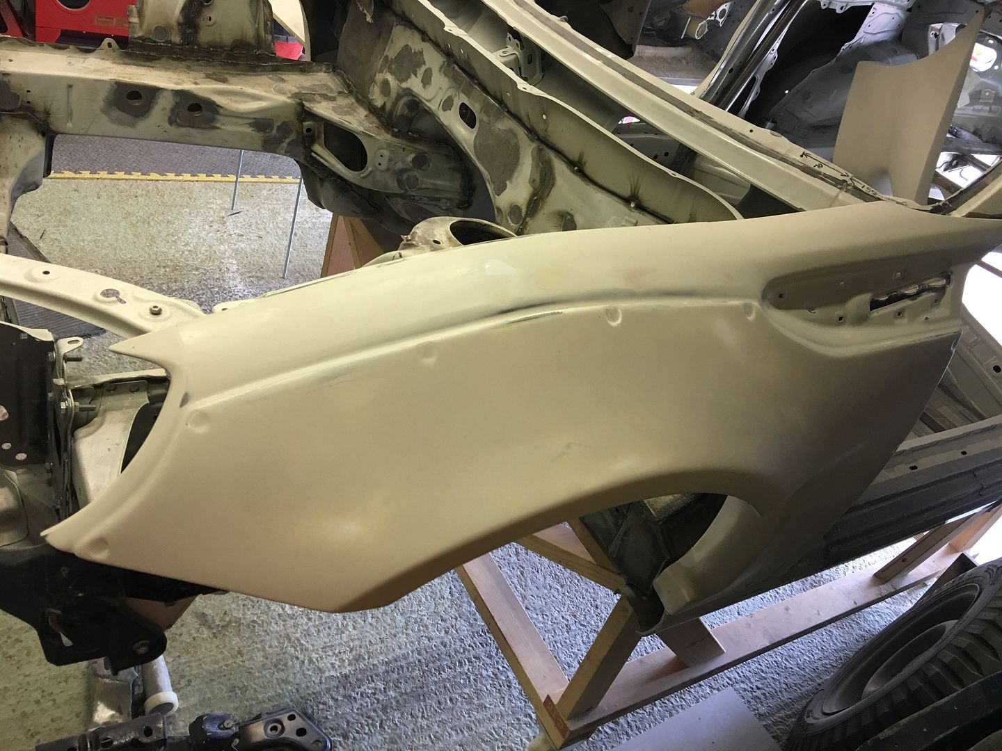

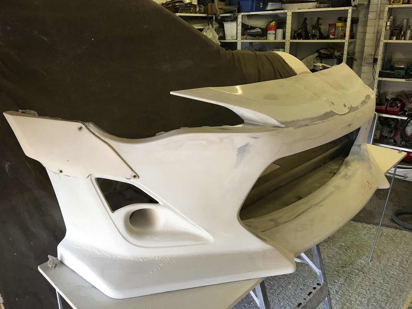

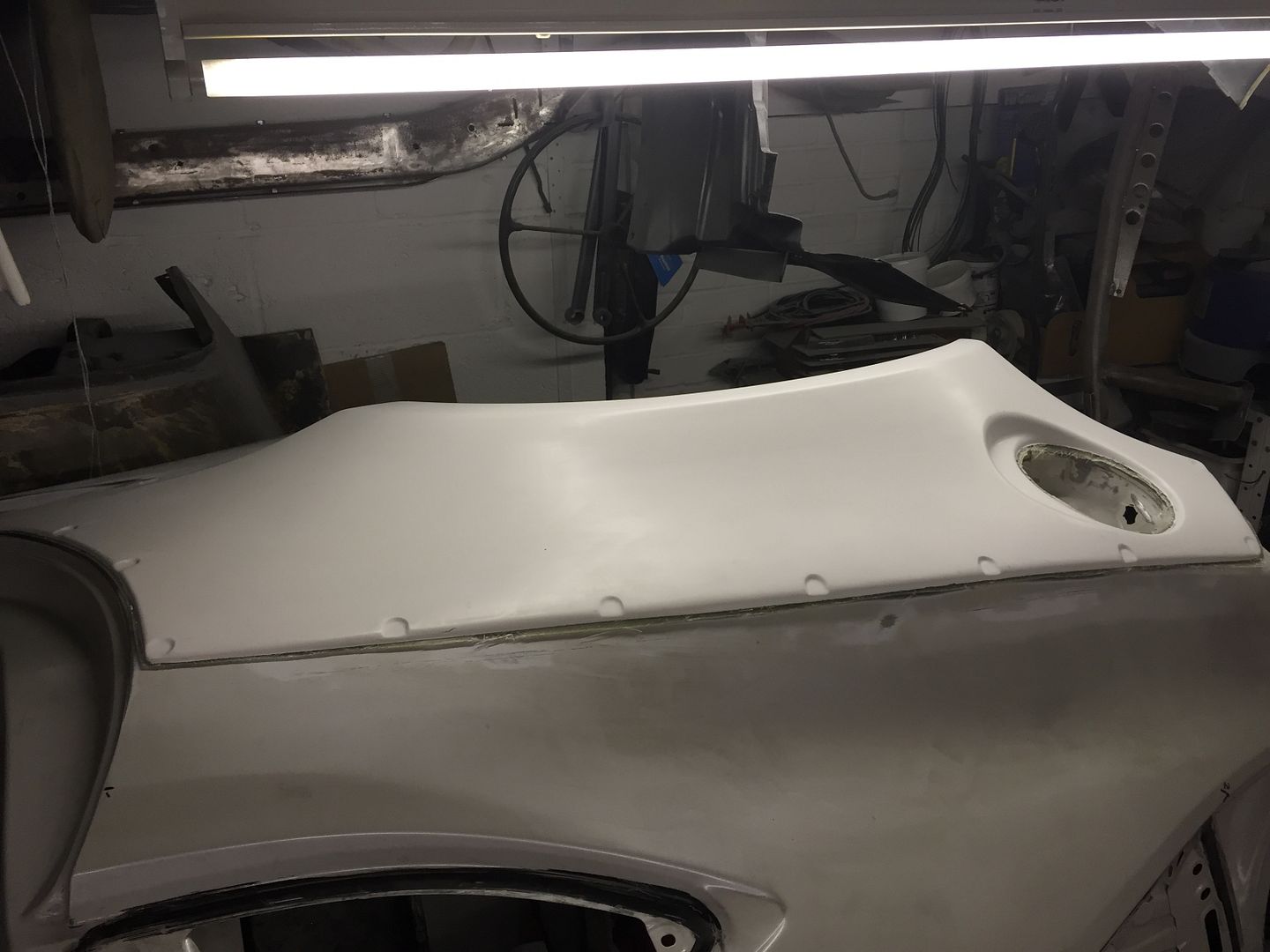

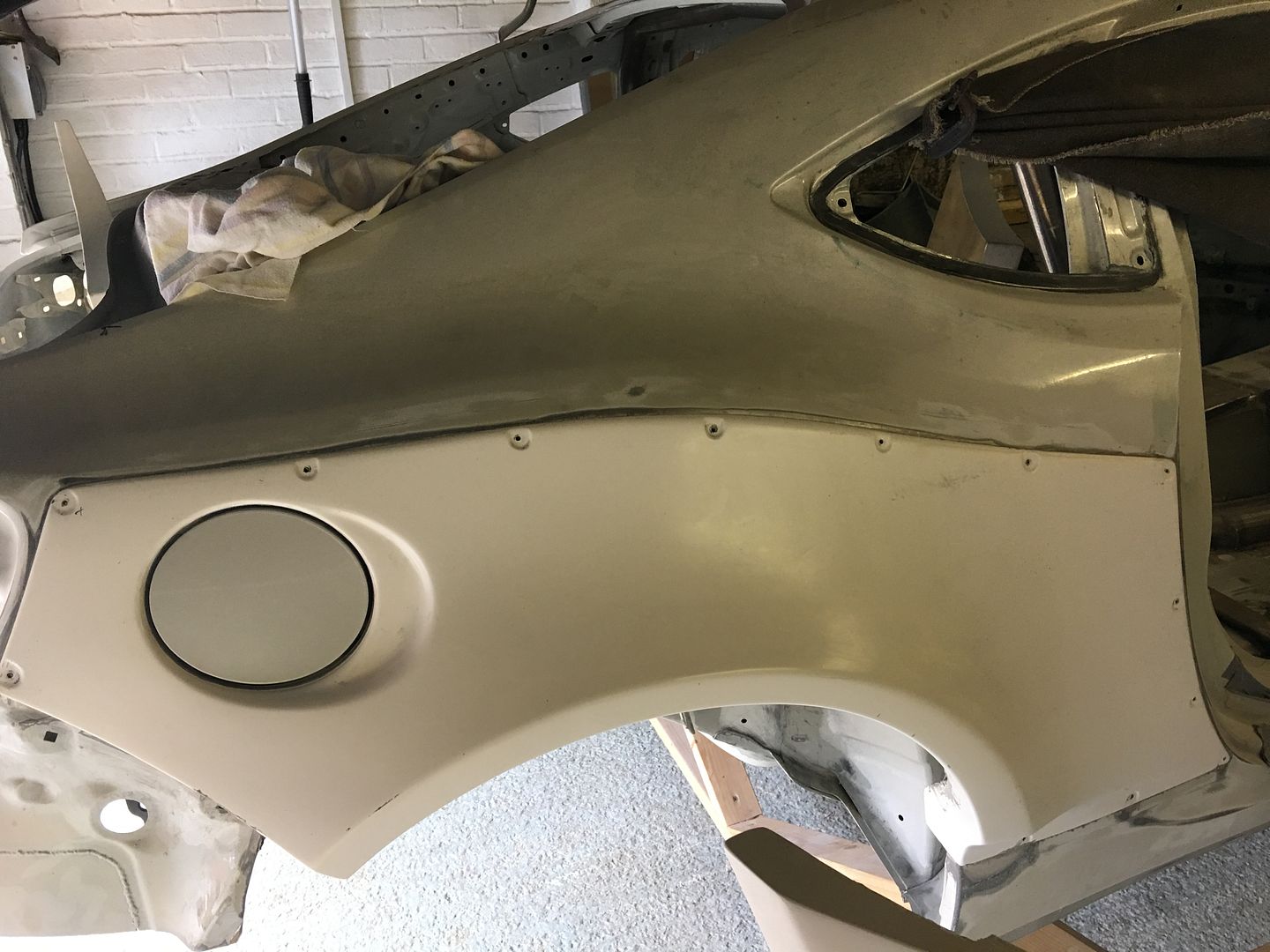

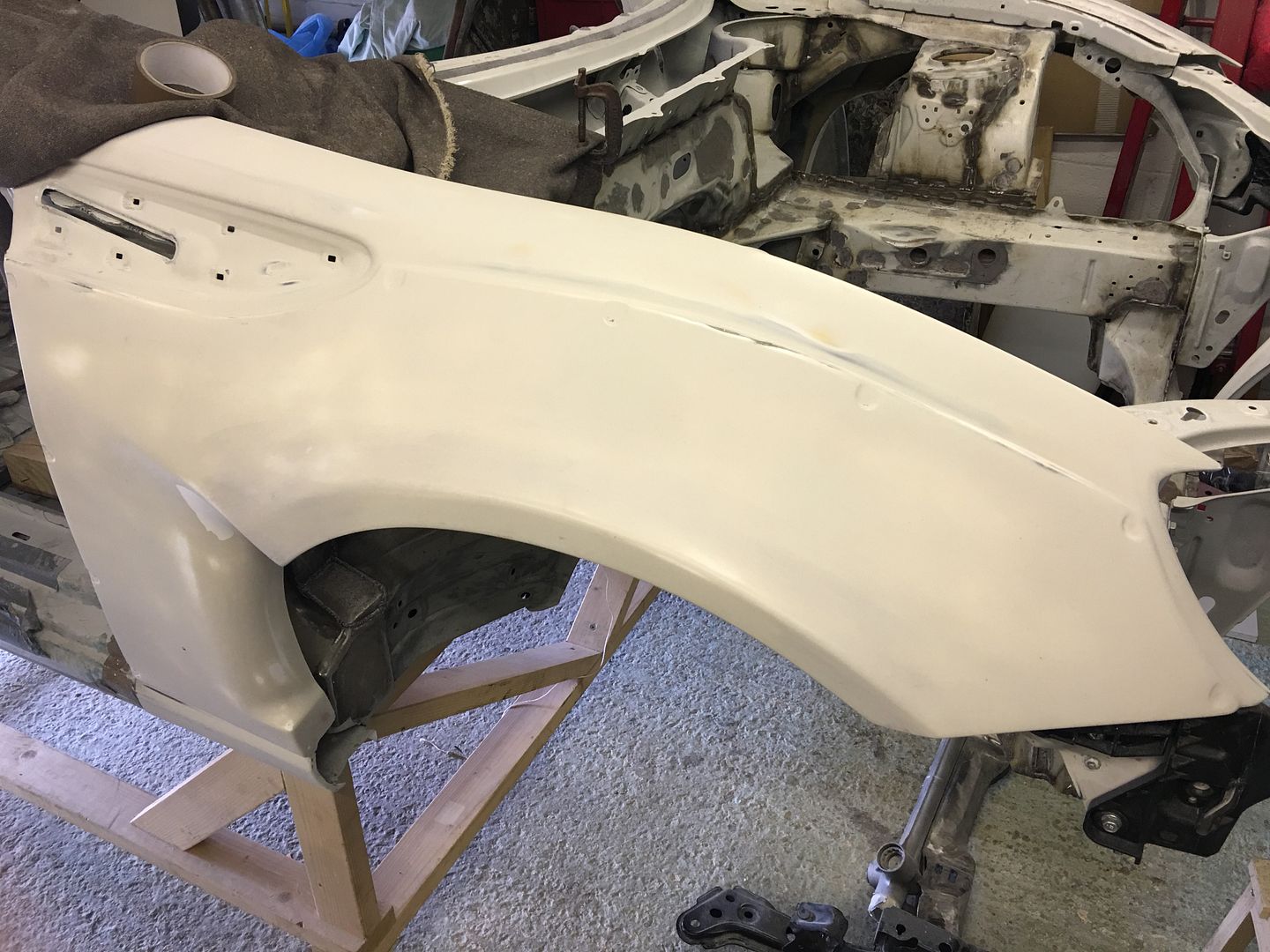

I have had a question asking just how well my panels fit.. so I thought i'd post a few pics of my body with them fitted..
The first four pics show the fenders glued to my body, ready for more mould making.
In the next pic we can see the right rear fender just sitting on the car whilst turned on its side. Note the panel is not yet trimmed.
Another way of seeing my panels is to look at this months Banzai magazine here in the UK, or follow rocketracoongt86 on instagram. I'm gt86nige on instagram

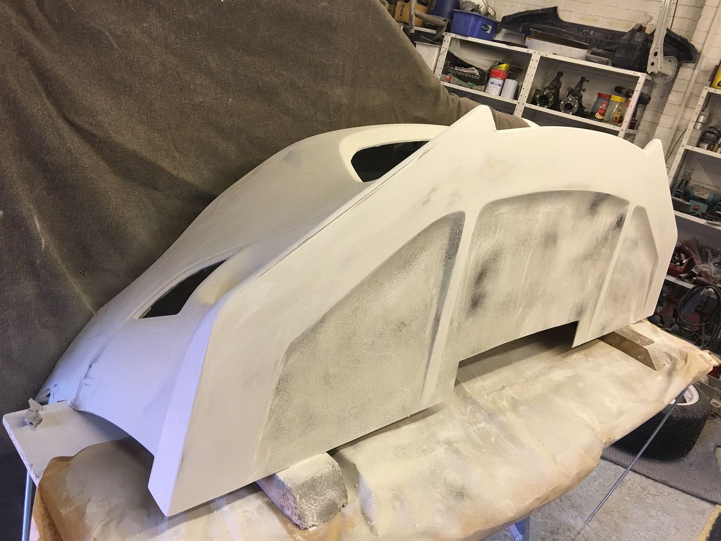

The front bumper is now undergoing mould making, here's a pic just before i started.
