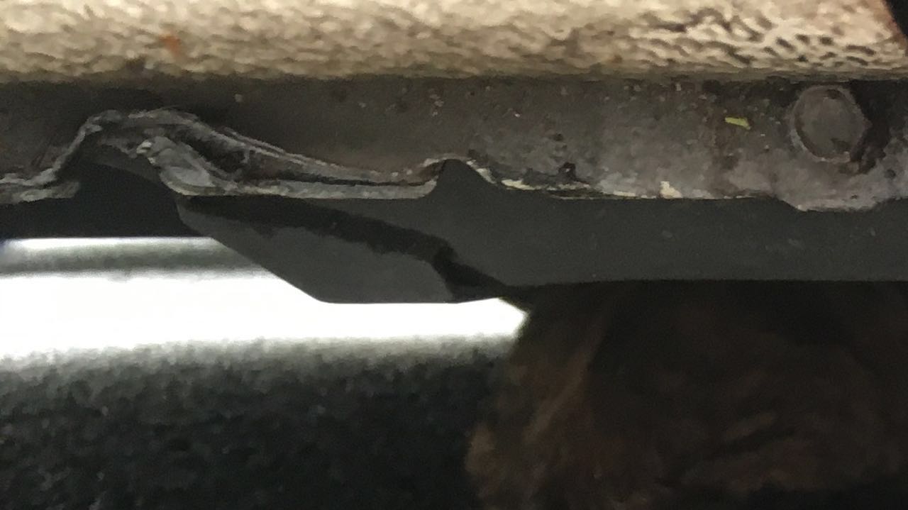

dent on the chasis, totaled ?
tried and failed to save the cat,
and noticed there is a damage,
shall I get it fixed ? is it replaceable ? value diminished ?
And I never remember how did that happen ?
http://www.ft86club.com/forums/attac...1&d=1464845515

Unless I'm missing something it's just the pinch weld folded over, looks like the jack or jackstand missed the doubled up lift point... slightly irritating, but I wouldn't sweat it.

It's totaled. If you continue to drive it the chassis will over heat causing it to bend and snap. Unfortunately the brake point will be just right under your seat. So when it does brake the shrapnel will cut through and quite literally cut off your junk.
But fear not I'll buy it off you for about $500.
Joking aside, if your worried about it a pair of pliers maybe a hammer and your done. Unless your anorexic 12 year vegan, then you might want to get some help.

so you all think the fold is due to the bad manipulation of the jack/lifter ? I only did the service in the dealer's authorised shop.. But I doubt if they can still admit it the service was two weeks ago..

I don't think a cat could cause that damage, but I don't know for sure.

Yes, probably hit something. See the broken plastic. Not likely from service.

Nah. Look at the shape and spacing of the bends. That is from a poorly place swing arm hoist.
@xtral
Like has been said it is not a big deal and nothing to worry about. Nice job on at least attempting to save the cat.
