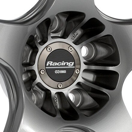

Well, now lupindub, I reckon you didn't do it right the first time ...... or ..... you had the studs oiled up ........
humfrz
Could be I didn't tighten down enough, although I tighten my other two sets of wheel in the same fashion. Only my recent wheel's are the only one giving me problems.
It could also be due to the concavity (not sure if this is a real word) of the lug stud hole on my new wheel's is so much more angled compared to the stock wheel's or my winter wheel's. I think the concavity of the lug stud hole on the wheel makes it easier for the nut to back out.
compared to stock
hmmmmm........I would think that the "concavity" of the seat on a rim for a lug nut should be standardized ...... ??
Are you sure your lug nut wrench/socket is not binding on the sides of the wheel and giving you the "feel" that the lug nuts are tight .. ??
humfrz
Nope the wrench never even touches the side of the wheels since the wrench itself is angled.
I actually took my lugnuts off the first time I put them on thinking something was wrong and just to inspect the lugs and lo'and behold the sides of the lug nut was way more scratched up compared to before. So yeah, like you mentioned it could be that the lug nuts are binding to the side of the wheel causing it to feel tight... not the wrench/socket... i'm sure this is what you meant right?
