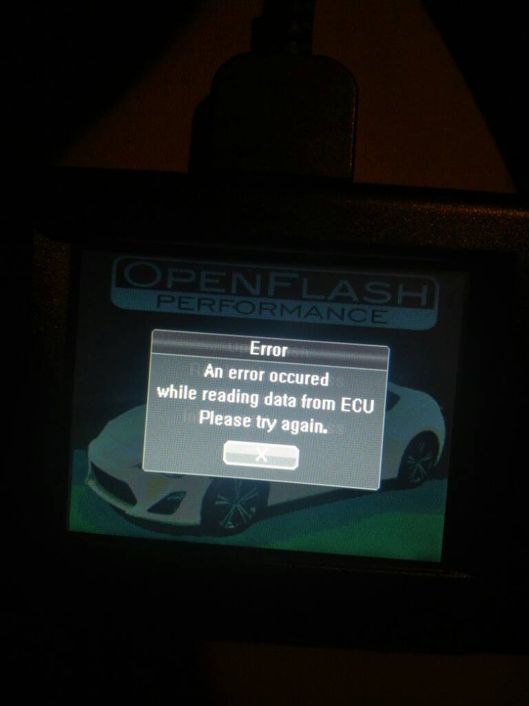

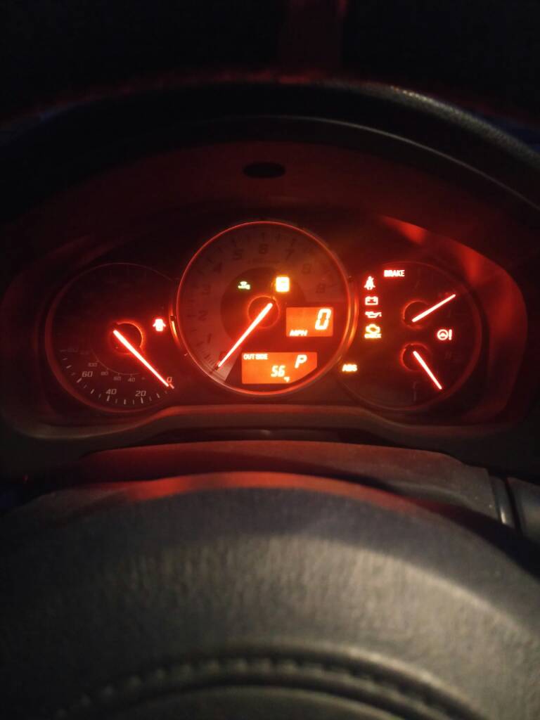

I'm having trouble reading my stock tune. 2015 FRS bought last July. Made sure ignition was full on without engine running and got an error when trying to read. Turned the car off and tried again after a minute and same thing. Diagnostics work when I run the engine and check real time data though... So idk what's going on... Help? Automatic transmission as well.. And was recently received back from dealership for TSB on the idle issue around 1000rpm.
Attachment 137201Attachment 137202
Sent from my ONE A2005 using Tapatalk
hmmm you seem to be doing everything correct.
assume its was brand new and no chance of an ecutek or brzedit tune in it
In the diagnostics screen or ecu info screen can you read the vehicle VIN number and calibration ID ?
ive seen one case where the dealer did not set the vin in ecu.
also try resetting ecu by turning car off and removing a battery terminal then press brake pedal, leave it for a minute then reconnect battery.
Unfortunatly this will also reset entertainment system setting and may require you to enter the radio security code so make sure you have that.
then try reading the ecu again
oh forgot make sure you have selected toyota and ZN6 as vehicle in the oft screens
steve99 is offline   Reply With Quote
Old 05-18-2016, 07:49 AM   #542
leunglambs
leunglambs's Avatar
Drives: FRS RS1
Location: Philadelphia, PA
Posts: 96
Thanks: 36
Thanked 23 Times in 20 Posts
Yupp, cars brand new. Dealership only flashed it recently to fix a TSB on the idle issue.
I can read the VIN and CAL ID with the OFT.
When you mean press the brake pedal, do you mean leave it depressed for a minute or just press it and then leave it alone for a minute? Also, do you know where I can get the radio security code? Is it in the owners manual?
Thanks
Thanks
yeah just a couple of sconds its just to bleed of any residual power in system
if it still does not work contact the oft guys on phone you might have a faulty unit
