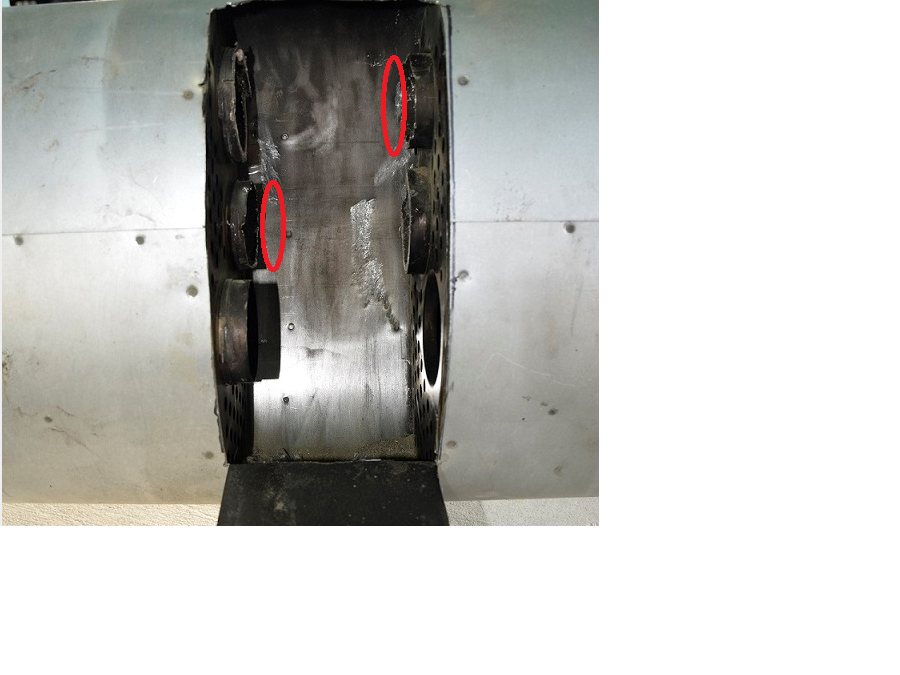

Ok,, finally got around to cutting open the muffler. All cuts within the spot welds. I'm thinking I'll put a plate that covers the whole right side,,, and also cover the left side non-issue holes.
Cutting the pipes off was a bit of a problem. My 4.5" grinder/chop saw couldn't get in there. I ended up using a reciprocating saw to chop off the pipes. It was PITA.
I left a flap on the muffler skin as it'll make it easier to weld it up.
You'll notice in the first picture that internally those larger sections that run to the tips have perforations and sound absorbing material. Not a lot,, but some.
As a sidebar,, got my 949Racing 17x9 rims, BFG tires and Racecomp springs this week! Sweet.

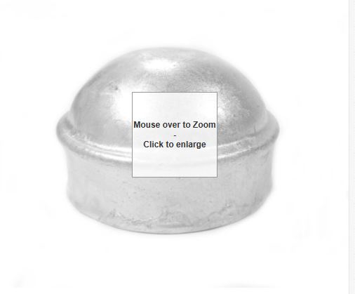

Ordered a couple of these from ebay this AM,, $7 shipped. They're galvinzed post caps with a 2.5" ID. These should slip over the open unused pipes and I'll put a couple of tacks on them to keep them in place.
As a sidebar,,, anyone ever use a Decibel App on the Iphone??

Originally Posted by Keenercarguy View Post
Sorry OP for the thread jack, and I bet you'll love the RCE Springs!
No worries,,, the more the merrier. It's a pretty clever solution you came up with BTW. I've got a couple of projects around the house to finish before the springs go in,, so it'll be a couple of weeks before I have time. Happy wife = happy life.
TURBOCAT,,, nice work on the refit. That's just a flow through with perforated tube and some type of sound suppressor I guess?? Makes me think I should cover all the holes in the baffles on mine. I picked up a small lightweight steel plate at Home Depot last night for $10 that will make the baffle covers. I'll try to cut it to fit tonight. I'm $47 into this at this point. $3 more and I'm over budget
