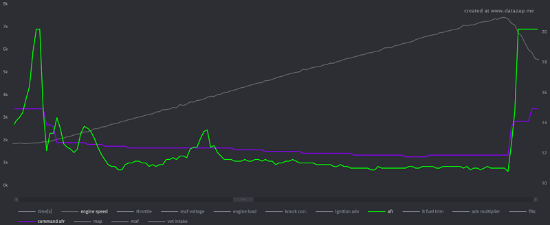

Load limit for P&L 4-1 EL catted (WIP):
Before:
http://datazap.me/u/akyp/20160221-st...zoom=1626-1779
After:
http://datazap.me/u/akyp/20160229-st...zoom=6120-6267
The first thing I wanted to address is the lean spikes which contributed to tip-in knock. With more time I can make the AFR plot flatter, but I'm leaving it for now as it took me enough time to reach this point (car is not DD). Currently using "v97.US.Lean Stg2" MAF scale from the spreadsheet linked in OP but I took the liberty to modify the value at 3.2v from 64.60 to 68.00 as it looked out of place.
Thanks @Wayno for this excellent guide. The load limit is just the beginning. It is my eventual goal to dial in AVCS maps (with vgi's tool) for this particular header.
akyp is online now   Reply With Quote

Yeah 68 is the value to use if you want to flatten out that area, though it doesn't make it look much less weird compared to the rich scale. I just use 1.0 below 2400 now because the ace header doesn't need workarounds like that. Good that you used the guide as intended to work out your own values you need.

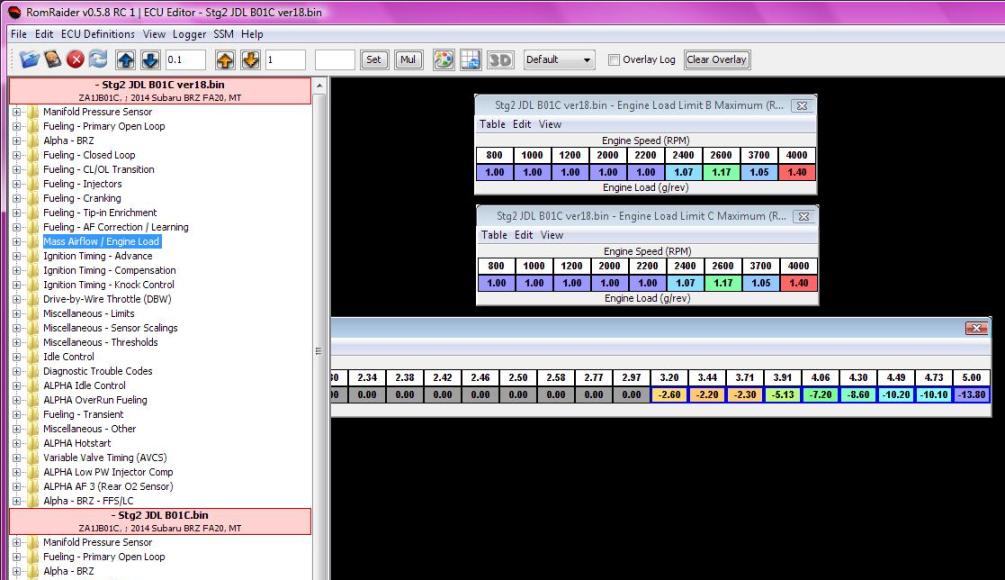

Just wanted to post a little BEFORE and AFTER here of my OFT Stage 2 tune with JDL UEL header, results from using this guide by Wayno.
My current Load Limits, and MAF scale (compared to the standard OFT maf scaling):

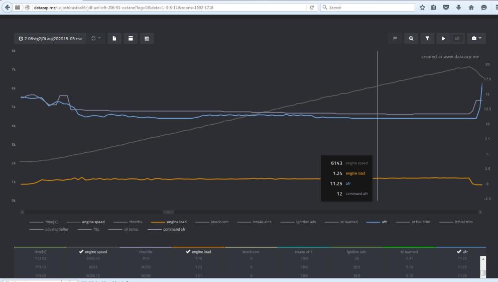

Before- OFT stage 2 tune, 91 oct with no modifications.
http://datazap.me/u/joshbustos86/jdl...zoom=1592-1718

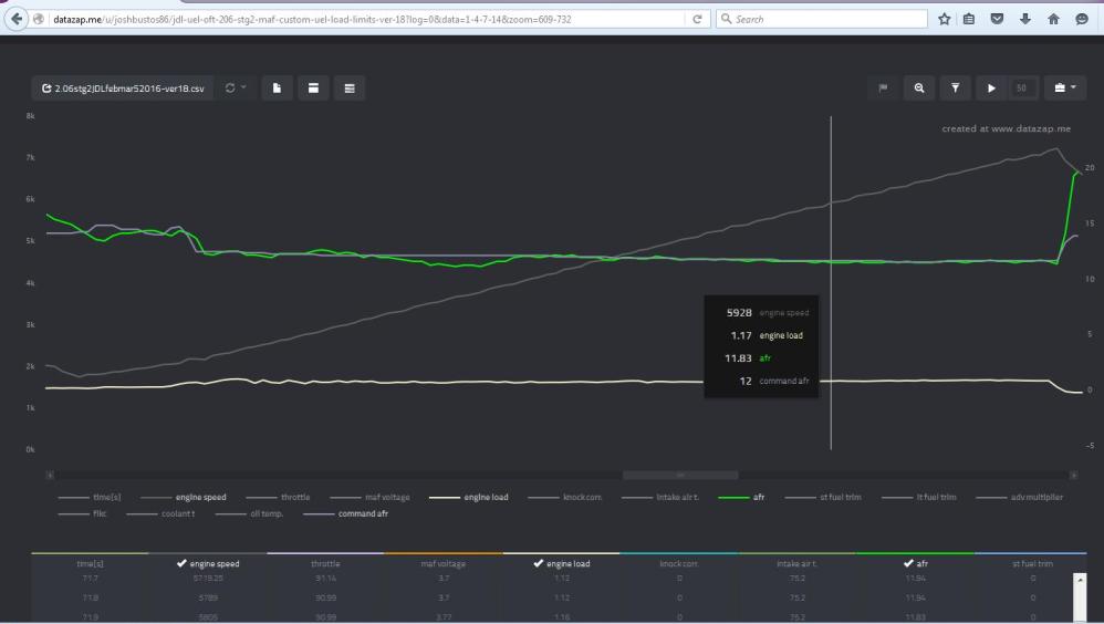

After- OFT stage 2 tune, 91 oct with custom OL maf scaling/ Load Limits and modified DI/PI tables based on Wayno's modifications.
http://datazap.me/u/joshbustos86/jdl...4&zoom=609-733

I run the original port injection ratios above 5k now, just in case Toyota has them there to keep the intake valves clean. I haven't seen any proof that running 100% direct from 5k to 7k is safe long term and I haven't seen any evidence that it produces more power, only that you can run about 2 degrees more advance with 100% DI, which may not necessarily mean more power if some PI thrown in produces a better mixture.

^ It would be a good idea for those of you messing with the load limits to log the cam timing as well to better determine whether the lean spots are caused by scavenging effect. The valvetrain noise caused by aggressive overlap may also contribute to knock, or rather "knock". (in quotations because this may not be real knock)
Before:
After:
