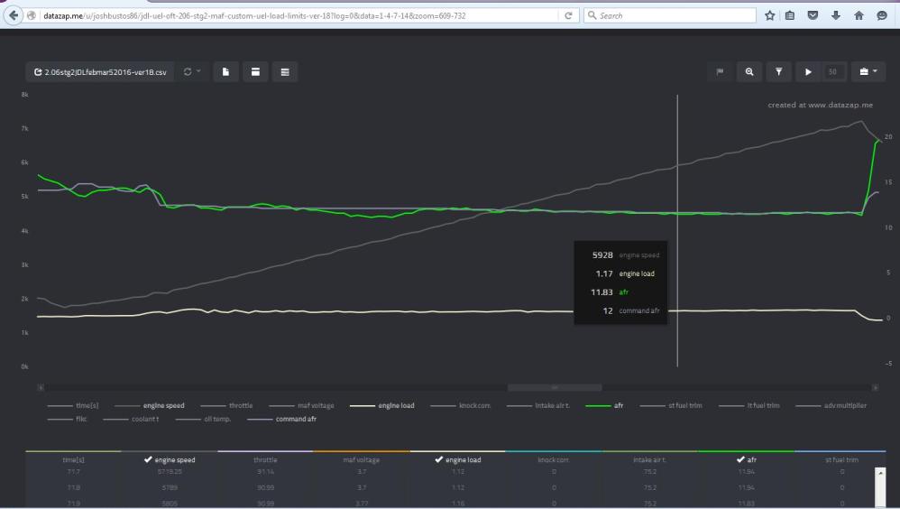

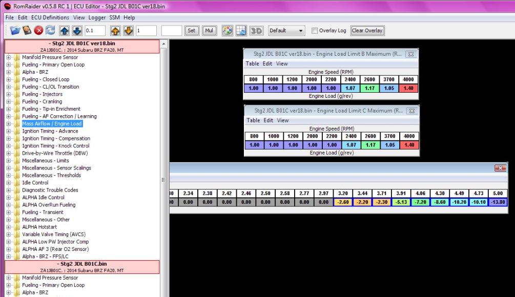

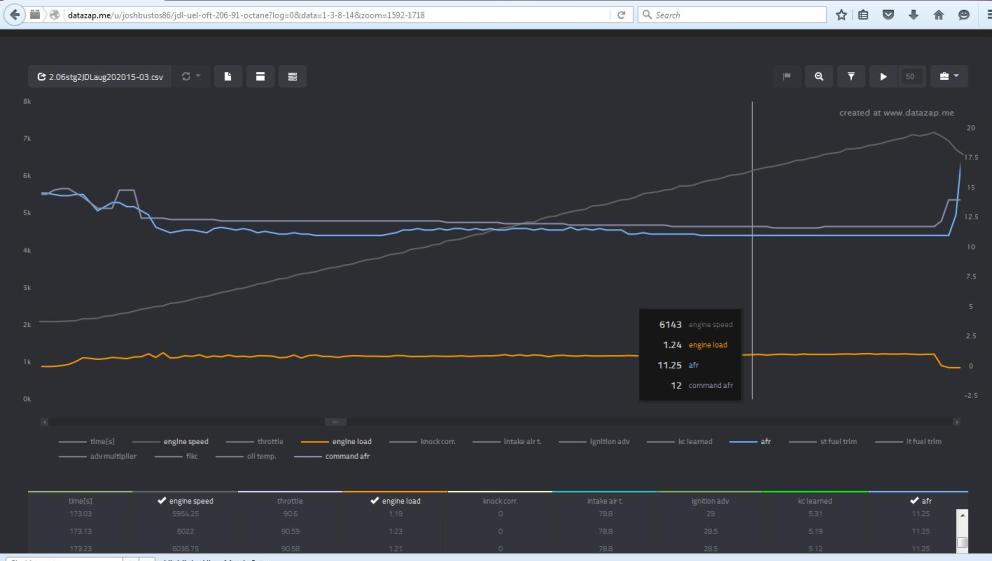

Just wanted to post a little BEFORE and AFTER here of my OFT Stage 2 tune with JDL UEL header.
My current Load Limits, and MAF scale (compared to the standard OFT maf scaling):
Before- OFT stage 2 tune, 91 oct with no modifications.
http://datazap.me/u/joshbustos86/jdl...zoom=1592-1718
After- OFT stage 2 tune, 91 oct with custom OL maf scaling/ Load Limits and modified DI/PI tables based on Wayno's modifications.
http://datazap.me/u/joshbustos86/jdl...4&zoom=609-733
Many thanks to @Wayno and @steve99 for the guides and assistance.

Did you try 1.02 at 3800?
Attachment 132567
Attachment 132565
Attachment 132566
I've had it at .9, 1.0, 1.1, and differing between 3600, 3700, and 3800. When it's set to a place where the load limit exceeds it, it helps the AFR but only for a short 100 RPM range and the rest is still rich. So I gave up and just left it at 1.05.
JB86'd is offline   Reply With Quote
Old 03-07-2016, 11:36 PM   #973
Wayno
Wayno's Avatar
Drives: Toyota 86 GTS
Location: Australia
Posts: 1,129
Thanks: 453
Thanked 896 Times in 424 Posts
Mentioned: 211 Post(s)
Move 1.17 to 3000 rpm, make 3800 1.0. It doesn't matter very much if WOT is lean below 3000.
Or if it feels fine, leave it as is.
