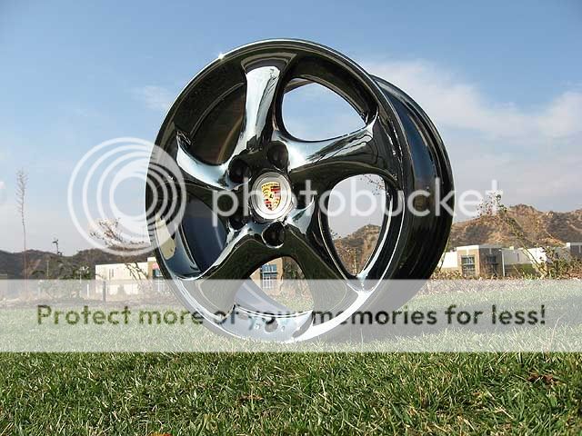

These are the closest I could find to SBC in Powder. They look pretty good. Don't know anything about durability of finish or the process...
Since you're in NY you should have many good installers in your state.
http://forum.wheel-whores.com/viewtopic.php?f=4&t=17499

I'm not positive but I don't think powder coat can make that glossy finish, nor can it do chrome. Someone correct me if I'm wrong. They mention paint in that thread, maybe someone was mistaken?

it most likely can, although I have a feeling it would involve multiple coats. sandblast, charge, primer, chrome, gloss.

Here's a shit job that could clearly be improved upon. Still don't know how close to SBC it can get, but I think it's do-able.
[ame="https://www.youtube.com/watch?v=5O4CPt3xfcw"]Powder Coating Real Chrome - Mythbusted - YouTube[/ame]

Wasn't OPs goal to look like dark chrome though? I don't think powder coat can achieve the shiny finish of a chrome or similar plating
