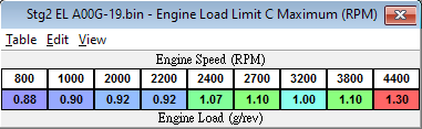

I was trying to change my load limit table like Wayno shows but my table only goes to 3200 Wayno's goes to 4400. I'm using the OFT C series def's. One other thing Wayno shows load limit table B, Do you change table A too? I'm sure I'm overlooking something.

Copy and paste both tables.

You can edit the axis, not just the values.

I could use some help in dialing in the load limits. My car has an EL 4-1 catted header and apparently, none of the load limits on the first post fit perfectly. Below is the most recent log and the current load limit is attached:
http://datazap.me/u/akyp/20160126-st...4&zoom=825-961
Notice the rich lumps at 2800 and 3200 rpm, then the lean lump at 3800. If I'm understanding it correctly, the rich lumps can be fixed by lowering the load limit which I've been slowly doing. However, raising the load limit at 3800 rpm probably won't help the lean lump, as it's already at 1.10, but the recorded engine load at that point is just 1.06.
Should I think about messing with the MAF scale or just use another scale (I'm currently using one of the scales from Wayno's ROMs but forgot which one)? Or am I doing it completely wrong?

Hello sir wayno, been reading this topic for a while and i tried maf scaling my rom. But i noticed that my cal id A01J and definition which is RR_ZA1JA01J doesnt have Load limit maximum (RPM) tables , is it possible to still do these maf scaling?and do you possibly have a definition for this cal id?

you dont need those tables for maf scaling
you only need to alter the MAF scale table flow numbers
if you redownload the romraider def tdd has updated it for your calid to include those tables
