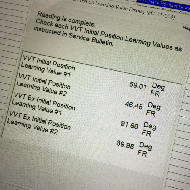

I talked to the mechanic at the dealer. Let me upload. Pic of what he got
Sent from my LG-D850 using Tapatalk

Originally Posted by Astroboy View Post
Attachment 129114
I'm guessing to that picture, your timing is off.
Correct. He said it could just be the ECM That's lagging. So I figured I'd just order the newer ECM which they have since then been putting in the newer car. I was about to order a sensor, but the mechanic told me it could just be the ecm.I will order that and swap it out myself. The mechanic was extremely cool about it.
