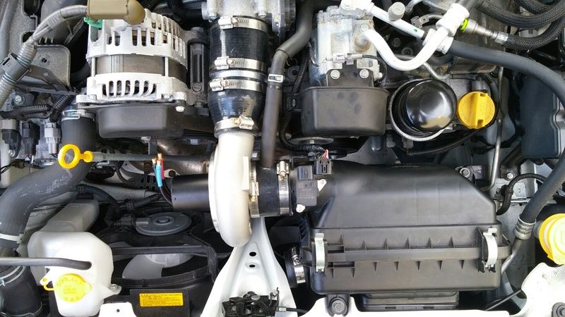

I am almost done installing esc and wondering these are correct fitment. I think i am ok with it but wanted to make sure
I didnt have enough time to finish it today but i will tomorrow morning.
I spent most of my time drilling that intake resonator. also make wires to go through driver to passenger side from center console.
also throttle switch wires barely made to controller!! hope Rob can make wires little longer for future customers.
It's pretty straight forward installation even you don't watch DIY video but it helps a lot.
I will post some DIY pictures and post when i finish it tomorrow.

Can you bring it just a bit closer to the throttle body? My metal connector sleeve doesn't show at all, and the whole thing is about .25" closer to the throttle body. Just my .02.

I concur. Also rotate the snail about 5-10 degrees clockwise.

thanks guys. I had test drive after installation this morning and Wow! more power!! this is datalogging i had.
http://www.datazap.me/u/zc06kissther...og=0&data=1-11
and this is just cruzing around~
I will try to make adjustment on throttle body and snail

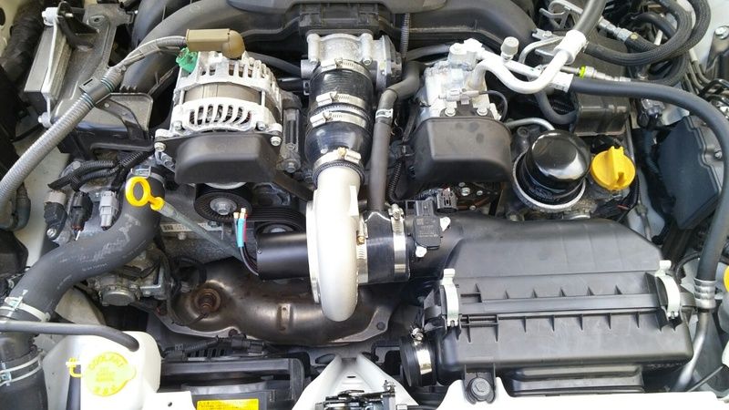

I made adjustments but snail section looks like little crooked because of its angle.. Should be ok? Little annoying to make it fit perfect. Are those datalog look ok?
